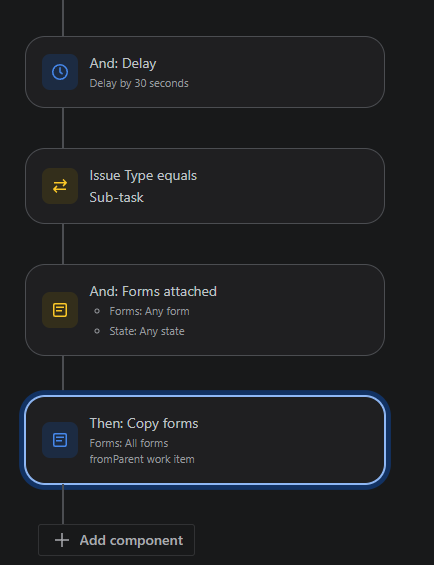

Colin Tammer
May 2, 2025
Hi Marc,
Thank you for the info, cant seem to make it work.
It does copy the form but it copies it into the Work item/Issue again.
I tried to make the delay longer, chose for all form and/or specified the one used.
Tried changing the Issue Type equals to a different Work Type.

Yes its a separate rule just for copying the form.
 I played around with the rule with different delays, to make sure the subtasks were there before the rule would run.
Tried with "Parent work item" and "Trigger work item"
But i keeps copying the form in the main work item/issue and not in the sub-tasks.

Can you show your full rule and images showing the details of any relevant actions/conditions/branches.
Also images showing the Audit Log details for the rule execution.
