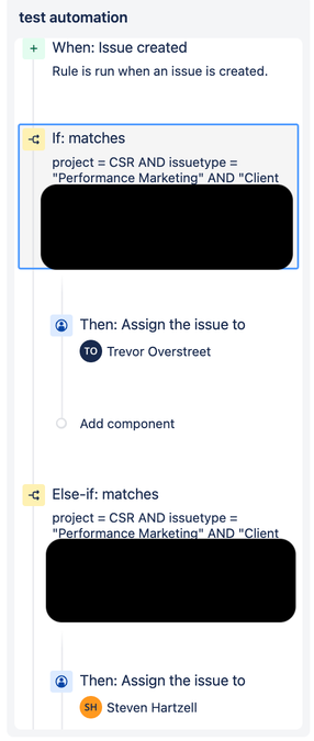

Current configuration: an epic is created and based on the ticket type a sub-task / different issue type is created under the epic.
I want automation to assign a user to the sub-task based on specified JQL. Currently I'm creating scheduled rules to check against the JQL and assign user BUT we have 20+ users who could be assigned which means 20 rules to be created / maintained.
Can I achieve this using only one rule to maintain? Thinking using the below logic but it's not currently working:
WHEN issue is created -> IF: matches specified JQL THEN assign user xyz
ELSE-IF: matches specified JQL THEN assign user ABC

Trevor Overstreet
May 9, 2023
Hey Trudy and thank you for the response! The rule errored on the parent task and not working (or running) on the subtask so I just created basically the same rule but the trigger is now Scheduled vs. of Issue Created. This works but the rule runs every 15mins vs. whenever a new subtask is added

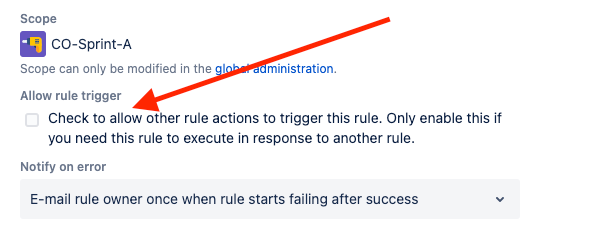

So the subtask is created by one rule, and in another rule you want to automate setting the Assignee. Is that correct?
If so, take a look at the Rule Details for the rule where you want to set the subtask Assignee. Make sure this box is checked:
Trevor Overstreet
May 10, 2023
Looks like that did the trick! Thank you so much
