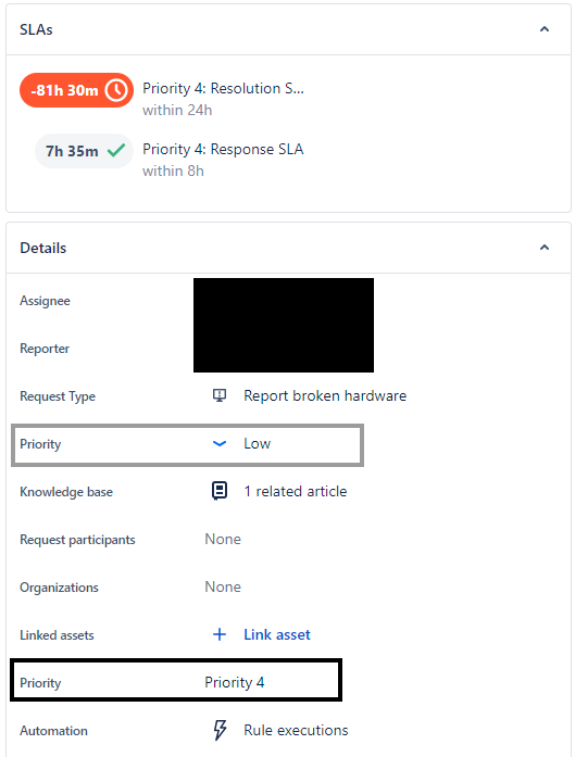

To define SLAs for different priorities, it can be done in different rules are a single rule. To define in a single rule, navigate to the SLAs, then select the rule and edit it. The JQL query would need to be updated as per the requirement.
Please find below the screenshot for a similar implementation.

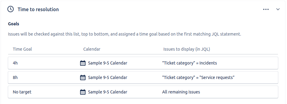

Hi,
Do you need different SLA counters for them, or is it enought with youse different time goals for the different priorities?
You can defined multiple goals in the same measure.
For example "Time to resolution" you can have separate goals based on priority instead of creating multiple new goals. (just change the JQL query for the goal)Screenshot from 2021-07-16 13-55-19.png

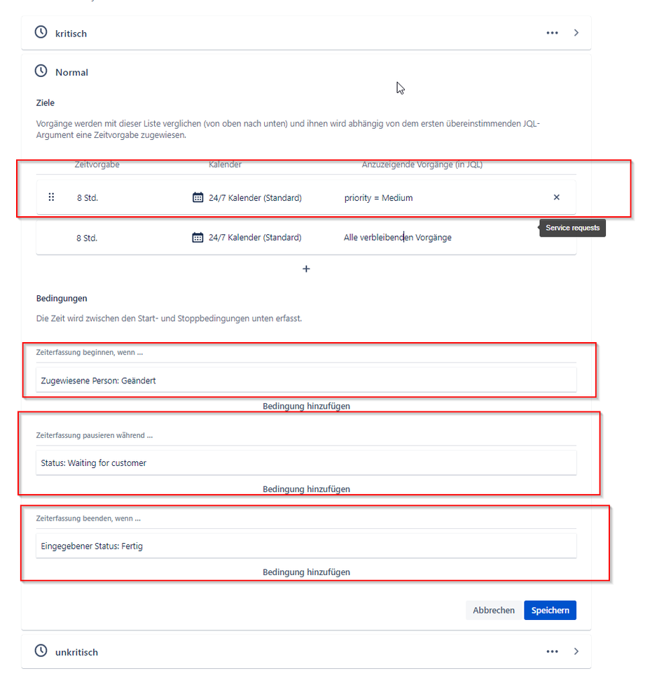

So i am still facing some Issues, i tried to make the changes simple, once in the ticket if i open it and we dont change the tickets into incidents or something else, we just leave them as : Email requests.
So i created the SLA's according to this:ticketcreation.png
the problem i am facing as you see the only "X" option to get rid of the 8h with the JQL "Alle verbleibende Vorgänge" menas, all remaining issues, cant be deleted. How come i can't delete that?
then further down in the conditions tabs i say, the time should start once a Agent assigns the ticket to someone.
The waiting time starts once changed to waiting for customer and the time ends, once the Status is changed to "Fertig" which is Finish.
So for the conditions i think it should be fine, and also for the JQL uptop (redcorner) i think it should be fine.

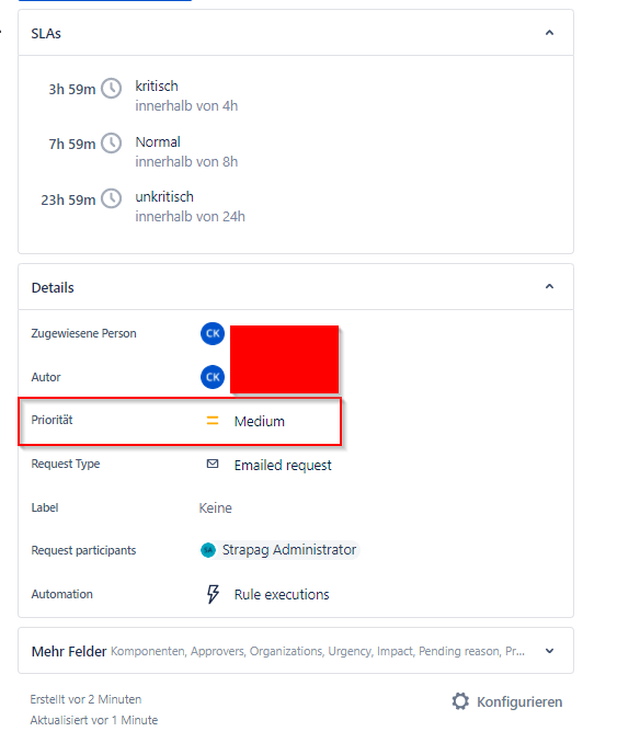

When i create a ticket and change the priority to Medium (see picture)
It still shows me all 3 SLA ( i think this is because of the all remaining issues field that i can't delete?
Or why do i still have all 3 SLA's shown inside the ticket ?

The SLAs work in a sequential manner. When a ticket is created, the system compares it to the defined SLAs aand assigns the one which matches the JQL.
So to cater to issues which do not match any condition, we have the SLA for 'All remaining issues'.
You can update the goal for this to 'No Target', which would keep the system for tracking the tickets which do not match your JQL conditions.

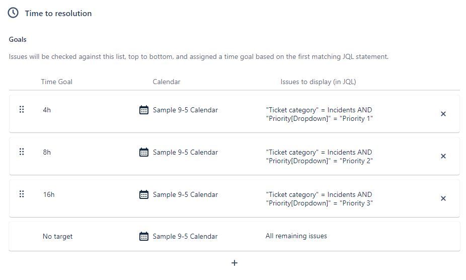

Also, you might have a case of using multiple Priority (like I am :) , refer the screen shot). If that is the case, we need to be careful while defining the SLA rules to ensure that we are referring to the correct priority (or JQL condition).
Once we have this streamlined, it reflects as Response and Resolution SLA on the ticket which keeps counting down. Please refer the screenshot.

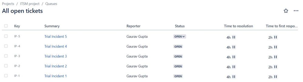

I managed to get it working the only thing that i dont quite understand yet is the time to responce counter in the overview where i see all tickets, that is still blank,
but the 3 different Prioritys work.
Did i understand that right, only if i have multiple SLA's on one ticket i get the orange timer in the Overview window?

In the overview screen, the SLA clock will show for every ticket on which it is applicable. Please see the screenshot, which shows 5 tickets and both Time to first response and Time to Resolution are shown for all tickets as it is applicable to all.
This can be edited by clicking on the 3 dots on the top right side.
Also, the timer turns orange when the clock runs out, that is when the SLA is missed.
