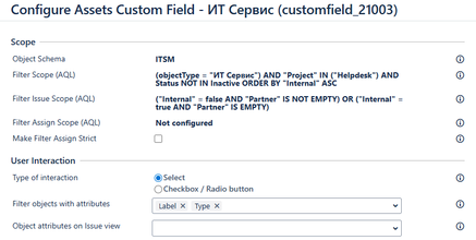

The situation is like this, there are 2 fields, one with Partners and the other with Services, and it is necessary that only their services are displayed for certain partners, and for the rest, or if no Partner is specified at all, the list remains the same.
I have configured links between directories and filtering in the dependent field.
This is not how filtering works, if nothing is specified in the Partner field, it outputs the necessary values, and when we select a Partner, those related to the selected partner are added to the current Services, although only the services of the selected partner should be displayed.

AQL: (objectType = "ИТ Сервис" OR objectType = "ИТ Сервис Internal") AND "Project" IN ("Helpdesk") AND Status NOT IN Inactive - it works correctly!
The problem is filtering the values associated with another field, when ${customfield_21001} is not filled in, everything works fine, but when I specify a certain value in customfield_21001, the selection list should correspond to the objects associated with it, but this does not happen, all values + values associated with this object are displayed.

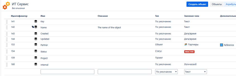

Are the Partner referenced as an attribute on the Services or the other way around?
This s required if Service and Partner are in different object Types in Assets.

Yes, there is a connection set up between these objects. The Service refers to the partner through an attribute with the link type Reference.

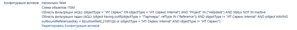

Following your instructions from the table, I found that the new user does not seem to be working as it should.:
("Internal" = false AND "Partner" IS NOT EMPTY AND object HAVING outboundReferences(objectType = "Партнеры" AND Key IN (${customfield_21001${0}}))) OR ("Internal" = true AND "Partner" IS EMPTY AND object NOT HAVING outboundReferences(objectType = "Партнеры" AND Key IN (${customfield_21001${0}})))
the condition after OR does not exclude values without links, but complements this list.
Why the OR option, this is the opposite of the first AQL, so it will complement the list.
