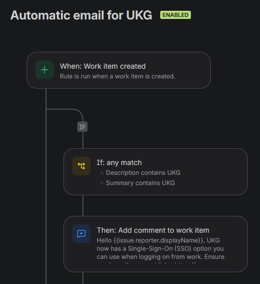

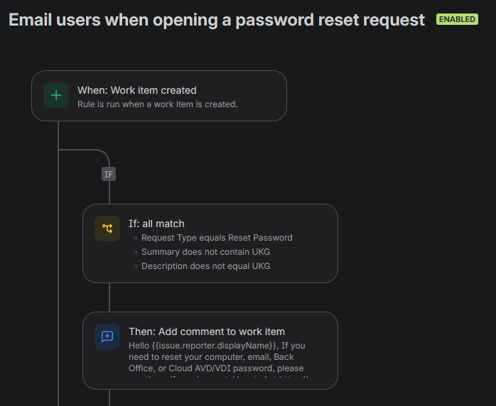

Hello, thank you for your response. An image of both rules have been attached. Essentially, when a user opens a ticket with either UKG in Summary OR the Description but not both, then both rules will trigger. When UKG is listed in both Summary and Description, then it is properly ignored. What I want is for the password reset as a whole to be completely ignored when UKG is either in the Summary and/or the Description, not just and, and then the UKG rule runs as normal. Another user suggested an if/else statement, but I am unsure how I would build this to function in the manner I am looking for.Screenshot 2026-04-07 120559.pngScreenshot 2026-04-07 120806.png

Thank you for this idea, but unfortunately, I'm not sure this is going to work. The reason is because one of the triggers also needs to be that the ticket type is Reset Password otherwise, it'll be added to every ticket that is opened. Is it possible to nest an if/else block inside of an if statement? So...
If: Ticket type is Reset Password
....If: Description and Summary not UKG
....Then: Password Reset Response
....Else: UKG Response
But then, even further, I need the UKG response to run on ticket types that also are not exclusively Reset Password types.

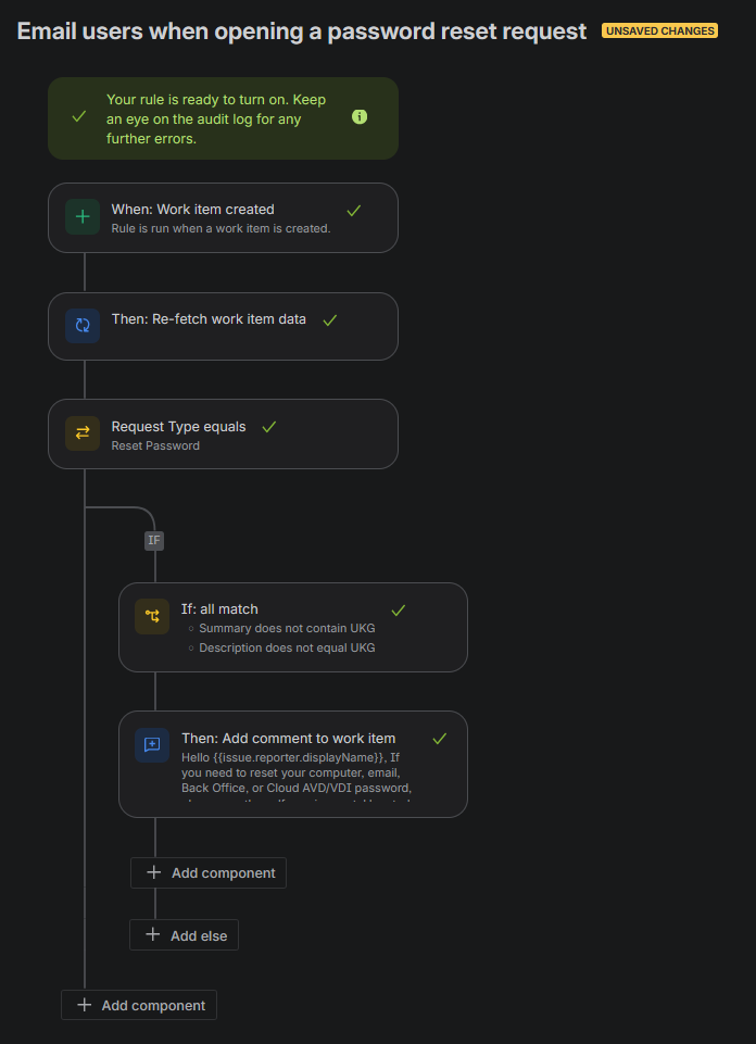

Yes, testing the type is a good idea to confirm it is a "Reset Password" one.
However, using two rules creates the need to test for all three other cases in one of the rules.  This is why I suggested using one rule to test the single case (i.e., neither field contains UKG) and letting the Else handle the remainder.
Having one rule also reduces the risk of them getting out of sync during any rule updates in the future.
