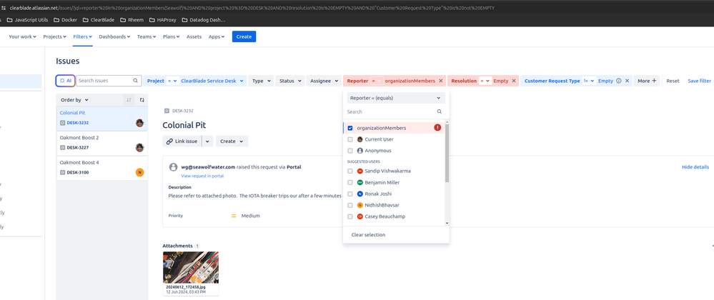

An existing JIRA queue recently started complaining about a search term with the problem being that "Your project and reporter selection is invalid". The reporter being the person who submitted a ticket.
As far as we know we did not change anything to cause this. What is going on?

Akash Sharma
June 15, 2024
Mikael,
Thanks for your help! The non-JQL query has been used by colleagues of mine for long time. The fact that the 'red' fields suddenly started showing up has been causing concern that the queue is no longer showing the right data.

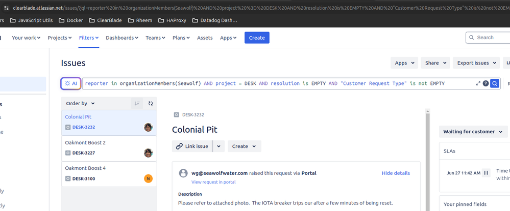

Looking at the JQL equivalent of the query I see this:
It does seem the query IS showing the right set of data. I am trying to assure my colleagues of this.
Is there anything I could change in the JQL to make the fields in the BASIC query not appear in red?
Thanks again!

Mikael Sandberg
June 17, 2024
It is showing up because you are using the basic view, it cannot use the organizationMembers() function, and that is why you see the error. You have to use the JQL view in order to use that function.
Akash Sharma
June 17, 2024
Thanks Mikael.
I had the wrong understanding that the JQL view and the BASIC view were just two ways of viewing the same query. It seems they are actually two different queries.
Thanks!
