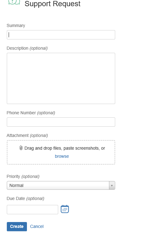

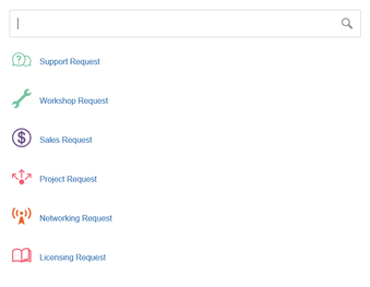

If Application access is enabled (JIRA Service Desk): the user can use the Create button.
if this is unticked the user gets the more generic Help Centre Portal but can still use the menu to create a new Issue. See below.
