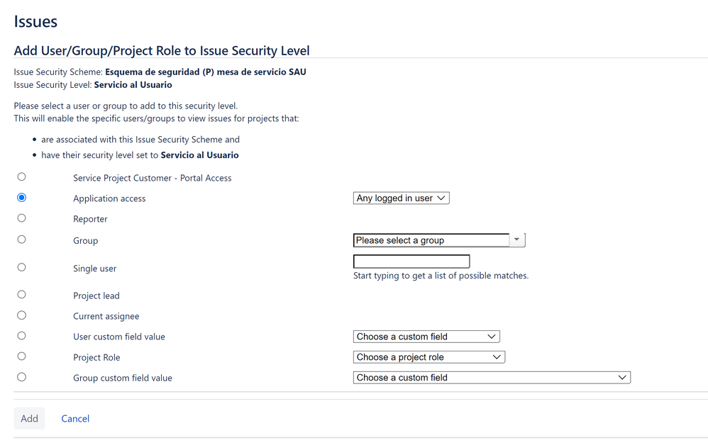

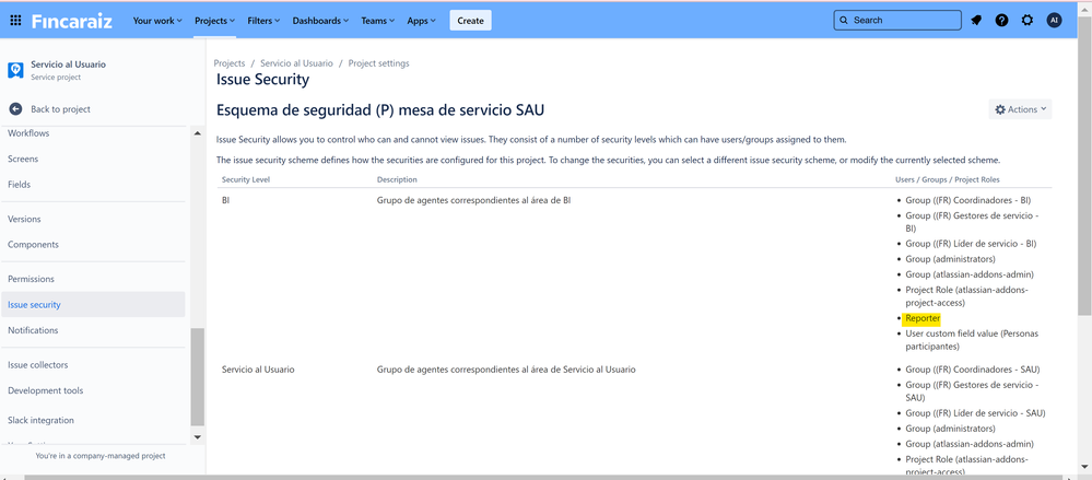

Hello, good afternoon team. I am kindly requesting your help, a week ago I setted up a security scheme in the 3 incidences, because there are 3 areas working on the same service table: Customer Service, TI , BI (img attached).reporter agregate.png

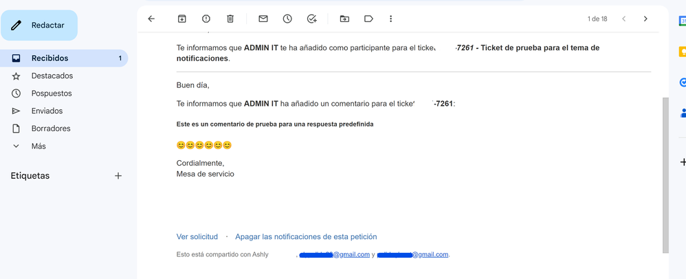

Currently, the security was adjustes so each are is able to see thei own tickets and restrict the access, but now it´s generating issues with the notifications that are arriving to the ¨Reporter¨and to the ¨Request participants¨ ticket. (Img attached)image.png
I was able to solve the notifications matter being sent to the ¨Reporter¨by adding it to the security scheme, but I cannot find the opcion to add the ¨Request participants. This is mandatory because the notifications also should be reach them.

If you add Service Project Customer - Portal Access (the first option) to the issue security that will allow the Request participants to view and get notifications for requests that they are added to.

It has really worked. The notifications have also arrived to the "request participants".
