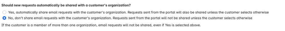

There is a global setting for JSM to automatically share an issue with the submitter's Organization:
https://yourBaseUrl/jira/settings/products/jira-service-management-configuration
That would automatically set the Organization field of the issue. But I suspect that the user must already belong to an Organization when they login in to the Portal (or submit their issue via email).

I have that option as yes.

I just setup a new organization and approved domain then sent a test and it didn't add the organization to this,  but sent a 2nd one and it added.
That aligns with my suspicions that
  • the first time a user submits a request they are added to the Organization after the request is saved in Jira
  • to add the Organization to the request automatically during creation the user must already be in the Organization.
You could work around this be having an Automation Rule that checks newly created requests to ensure the Organization field is set, and if it is not then set it.
of 20 organizations and 30 tickets there's 4 customers its adding to 3 organizations.
Do you mean that some users are added to multiple Organizations? If so, then for requests emailed by those users the Organization will not be set. That is the caveat noted in the statement below the radio buttons.
