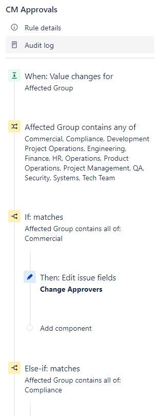

I am using Automation for Jira in JSM Cloud. I need to have a field drop down be able to be selected and each time a value is selected it then add an approver to the approval field. So if 5 values selected it will then add 5 different users as approvers.
Each value in drop down is a department and each department as a representative that is the approver.
I am using the if else for each value to make the change to the approver field but it seems it will only add on approver to the field not multiple.
Anyone else have this before. I have all approvers selected in the approval process.

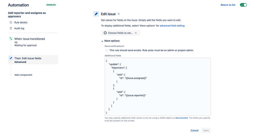

I managed to do so with dynamic values like so:
@Moshe Quantz Does "add" operator still work for you?
Im trying to do the same, but using add doesn't populate the approver fields for us. We need to use "fields" but i can only set one array of users
I was able to use Moshe's answer with the "add" operator. I kept running into issues because I was adding curly brackets in the wrong places.
Here's an example of dynamic (through a custom single-select user field) and hard coded (### = account ID) typed for easy copy/paste.
"update" : {
"Approvers" : [
"add" : { "id" : "{{issue.customField_10893.accountId}}" }
"add" : { "id" : "##########" }

In the automation I am adding Affect group values and then adding the person that is suppose to be the approver to the list of approvers. It is editing the approvers but only adding one approver. I need it to add all approvers to the approval field.

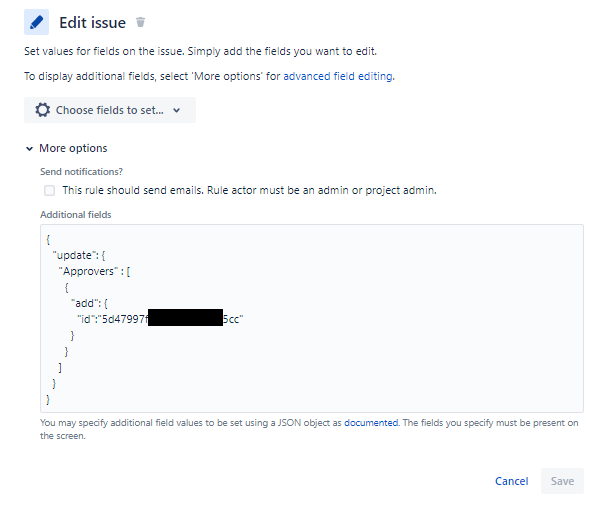

I found I had to use branches within the same automation rule, if I wanted to add more than one Approver to the Approvers field.
A branch within the rule for each user you potentially want to add as an Approver is not ideal. But this is how I got it to work in the scenario I had.
And when adding them, using the 'Edit issue' action in each branch of the rule, I had to use the Additional fields area with following JSON command, and provide the Atlassian user account ID for the relevant Approver I wanted to add in the Approvers list:
@Matt Lane your solution works for me. It now adds more approvers. The only problem I still have is that it approves the ticket when only one approves the ticket. But really all approvers would have to approve the ticket, when there are more then one approver. Do you have a solution for this as well?
@Mergim Rexha you would just need to configure the status in the workflow where you want the approval step to occur, to ensure its set to requiring all approvers to approve. I think the default setting when using the Approvers (multi approver user-picker) field, only requires one approval for the approve step to occur. But you should be able to change that to be ALL or more than 1 approval needed. If you aren't sure how, I'm certain there is likely topics and documentation on how to adjust your settings for an approval step in a workflow.
I was thinking that this would add each users based on the if else but its only allowing the edit of issue to be one users as approver. I need it to add each person as an approver.
