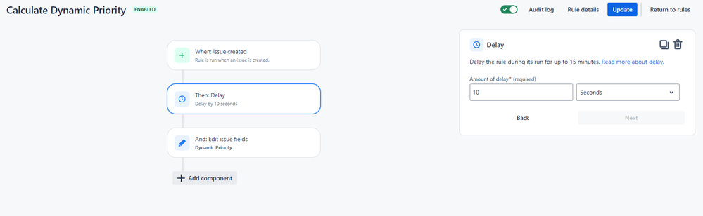

I am trying to add 2 smart values and then divide it by 2 to set a 3rd field value. I am using the following to try and just add the 2 numbers but it isn't working:
{{#=}}{{issue.Person Priority}} + {{issue.Issue Priority}}{{/}}
I would think that if this worked I could divide by 2 using this
{{#=}}{{issue.Person Priority}} + {{issue.Issue Priority}} / 2{{/}}
but with the Person Priority being 4(set by previous automation) and Issue Priority being 4(set by Post function), the Dynamic priority set by the above smart values = 4 instead of 8.
Any help would be greatly appreciated.

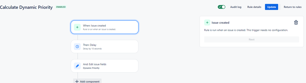

Hello @Anthony Esslinger
Is this in the context of an Automation Rule? If so, please provide screen images that show the entire rule and details of each step. Also please provide the details from the rule execution audit log.

The delay is to insure that the Person Priority and Issue Priority are filled before the next automation tries to add the 2 fields
As I mentioned you can use the Log action to write information into the Audit Log. You can find info on that action in the documentation for Actions.

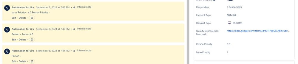

So I set up 3 comments to show the Person Priority. One happens when the ticket is created, next happens 3 seconds later and the 3rd happens after an additional 10 seconds. In all cases it shows that {{issue.Person Priority}} is empty but the value of the Person Priority shows up in the ticket as 3.5 as soon as the ticket is created. It just doesn't make sense, I don't know what I am doing wrong.
Please provide images showing your current rule and details of each step, since you have modified it.
You may want to try adding a Re-fetch Issue action to you rule, after the trigger. Sometimes the trigger happens before all data has been saved. The Re-fetch Issue action will re-query Jira to get the current data.
You can find the action described in the documentation.
https://support.atlassian.com/cloud-automation/docs/jira-automation-actions/
On a side note, you don't need to write the information in an Issue Comment. You can use the Log action I mentioned previously to write the information into the rule execution log. Adding comments can cause notifications to be sent to individuals related to the issue, which may be undesirable.
