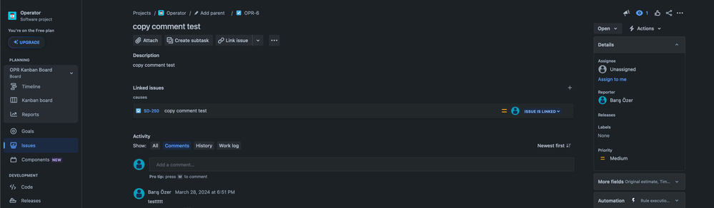

Hello,
I want to automate as follows.
When the task is created in the Service Desk project and the reporter X person, this task will be issue linked to another project. When a comment is made in the issue linked ticket, I want the comment to be written automatically in the Service Desk project.
The details are as follows;
project Service Desk
Reporter X
issue linked X Project
X Project is being commented.
When a comment is made in Project X, I want the same comment to occur in the Service Desk Project.
Can you help me please.
Best regards,

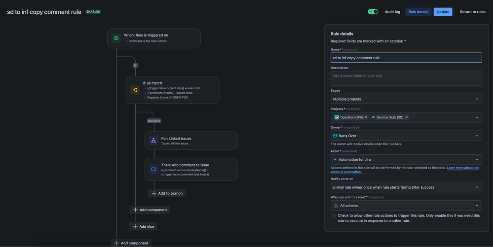

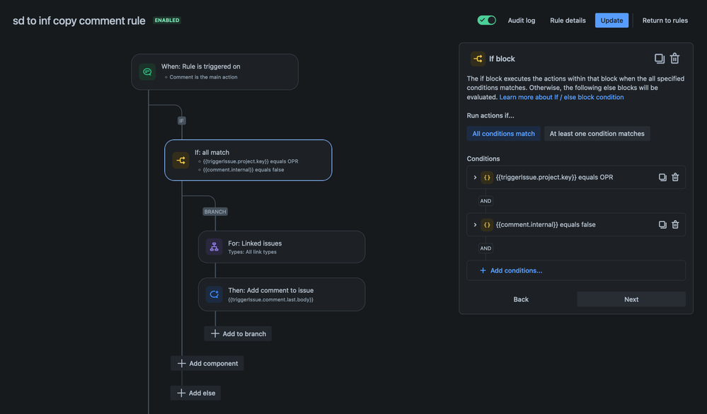

Hello @Trudy P Claspill
I made one rule. It works as I want.

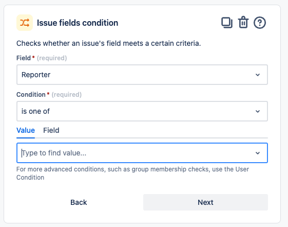

Trudy P Claspill
March 28, 2024
You can add an Issue Fields condition

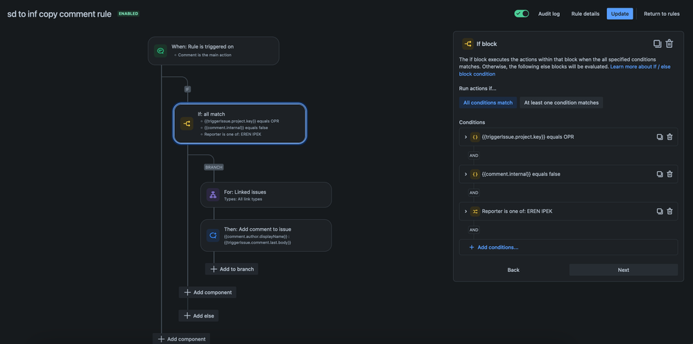

Hi @Trudy P Claspill
Reporter Eren Ipek is in the Service Desk project but it did not work.
What am I doing wrong?
Reporter Eren IPEK on the Service Desk side
But
reporter Barış Özer as it is a linked issue
The reporter on the Service Desk side is important to us.
On the Service Desk side, the reporters may be Eren Ipek, Ahmet, Barış. If so, I want this rule to work.

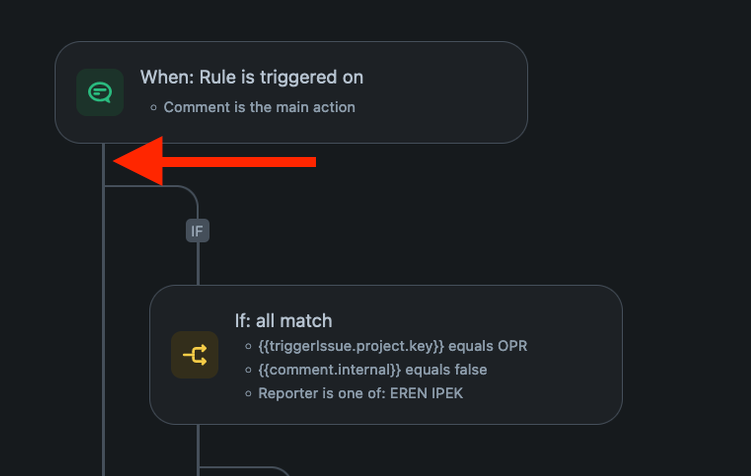

Trudy P Claspill
March 28, 2024

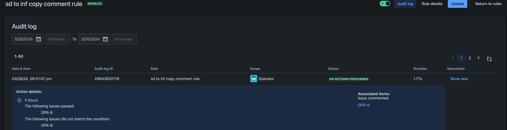

If you want the rule to run for Service Desk issues only when the Reporter in one of a specific set of users, then you do have to have a condition to check the Reporter in that issue.
Is OPR the Service Desk project?
According to the log, one or more of the conditions is not being met. I advise that you insert Log Actions here:
...to print into the Audit Log each of the smart values you are checking in your Condition. That way you can assess which of the conditions is not being met.
The OPR project is a Software Project, not a help desk.
I request your help.
I want the reporter in the Service Desk project to work when there is a specific person.
