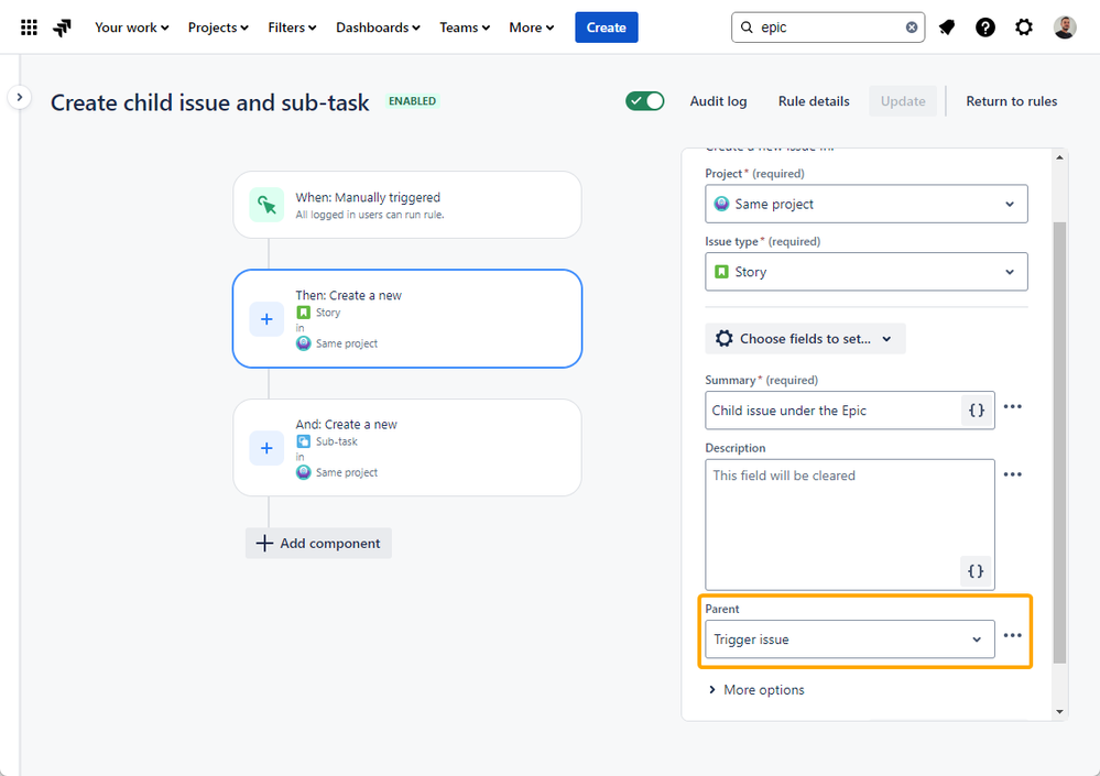

Hi @Carl Alde ,
Could you maybe explain a bit further what's the use case/requirement here?
I've created one rule that is triggered from the existing Epic. Basically, you can just add an action to create an issue (e.g. Story) and set Parent value to be the trigger issue. Again this is only my example as I've used a manual trigger in the rule.
The same thing would actually apply to the sub-task, where you would just use different issue type within the action.

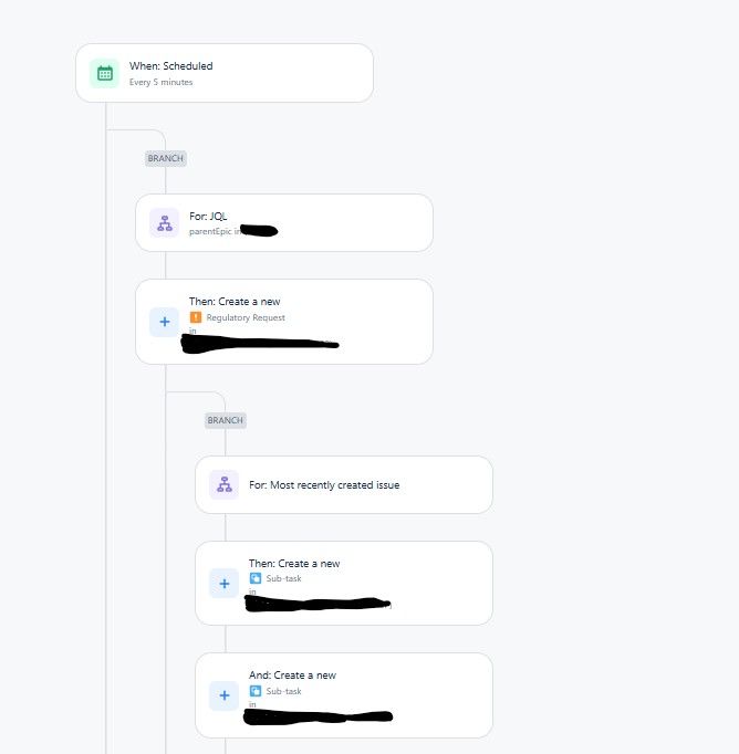

Hi @Tomislav Tobijas ,I was trying to create a scheduled automation to generate a task under an existing EPIC, as well as a subtask under the created task. My solution works perfectlyāI used the "Most Recently Created" issue for the subtask.
By the way, thanks for your response!
