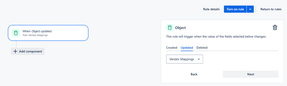

Hello @Justine ,
If you are a jira admin, you have a capability to write an automation with the trigger as "when object updated".
Hope this helps!
Vijay

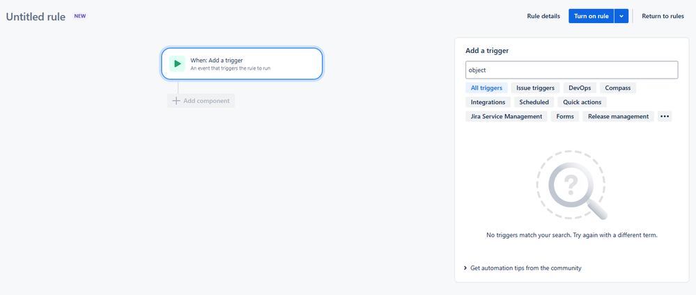

Justine
November 25, 2024
Hi Vijay! Thanks for the tip. When I go to create a new automation rule though, I don't even have the trigger of "When: Object Updated" available - what am I missing here?
Semih Tolga Yazici
November 28, 2024
Hey @Justine
You have to go to Global Automation rules. If you're trying to use the trigger that might affect the wider scope than the project, you should use Global Automation. You're trying to find that trigger from project > Automation.
You will find it if you go to Automation Globally from the system settings.
Cheers,
Like • Justine likes this
Justine
December 2, 2024
Thank you - that worked!
