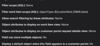

Could you post a screenshot of the context of the field
Sathishkumar S
July 20, 2026

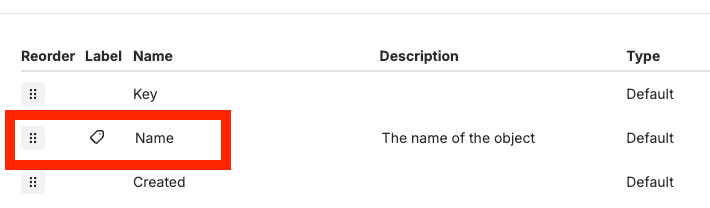

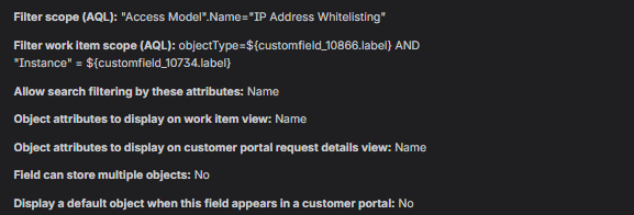

Trudy P Claspill
July 21, 2026
Is the filter you are trying to address the Filter work item scope (AQL) filter in your screen image?
If so, do I understand that you have verified that if it contains only the first part, then you get the correct list?
objectType=${customfield_10866.label}
If so, do I understand that it is when you add the second part you end up getting no results at all?
AND "Instance" = ${customfield_10734.label}
If I have that correct:
  1. Is "Instance" an attribute that is available in all the objects you get from the first part of the filter?
  2. What type of attribute is "Instance"?
  3. Does the Asset Object field customfield_10734 support selection of multiple asset objects?
  4. You said when you hard coded the value the filter worked. What value did you use instead of the placeholder? Was it the Name of the Object specified in the second Asset Object field?
  5. Have you confirmed that the Label option is set to the attribute of the second object that contains the data that will match to data in the "Instance" attribute? If it is the Name of the second object that matches to the "Instance" attribute, make sure that the Label option is set to the Name attribute of the second object.

I've taken a look at the screenshot.
Maybe change the Filter work item scope to:
objectType = ${customfield_10866.label} AND Instance in ($customfield_10734.label})
Like • Susan Waldrip likes this

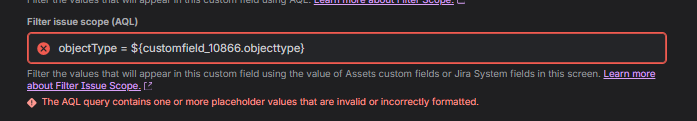

Sathishkumar S
July 21, 2026
Even this query not working. Listing down all the objects in the schema
Sathishkumar S
July 21, 2026
Syntax Error, when using objecttype instead of label
