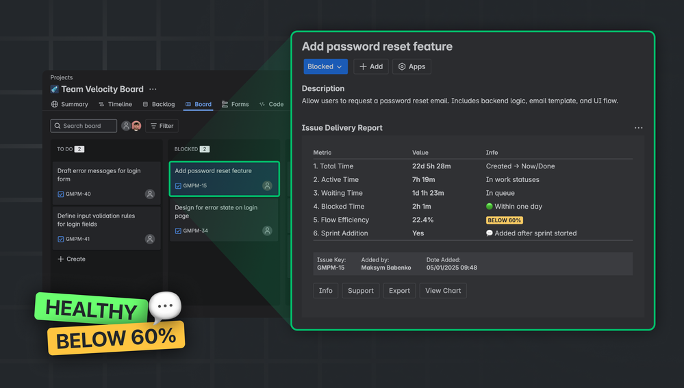

Hey @Mayur Gaikwad_Tech PMO  I had the same need on our team, especially for analyzing how long issues spend in each status and when transitions happen.
You might want to check out Issue Delivery Report — it’s a Jira Cloud app that uses the full changelog to:
  • Show when each status transition happened
  • Calculate exact time spent in each status
  • Visualize it as a timeline + pie chart
  • Export to CSV/JSON if you need external analysis
All of it is available inside the issue view — no scripting or API setup needed. Hope that helps!
