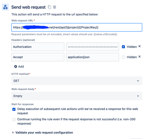

I am using the component Send web request as part of my Jira automation and getting the {{ProjectKey}} from "Create variable".
https://<domain>/rest/api/3/project/{{ProjectKey}}.
Using Basic Authorization to send the request.

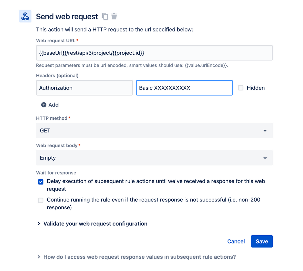

In addition, check the attached screenshot for a reference regarding authorization:

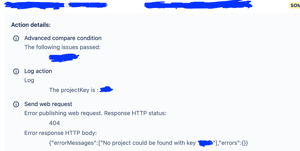

Got the correct projectKey in the audit logs.
Disabled and enabled the rule with no changes in the automation rule and it failed again with 404 error message.
