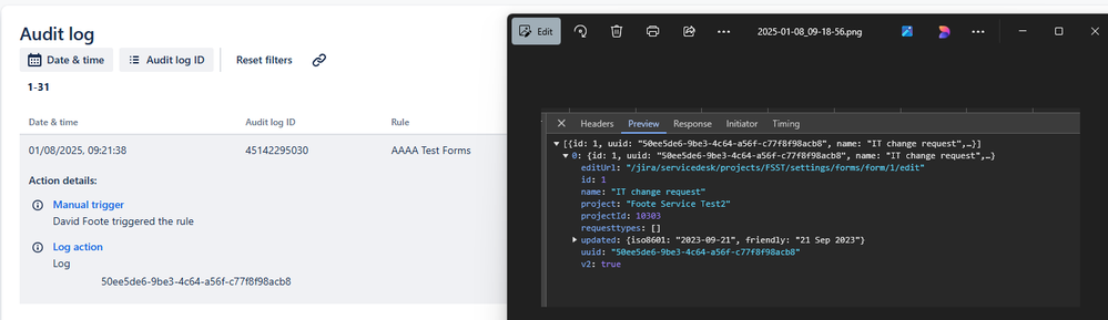

David Foote
January 8, 2025
@Kelby Corr
Not sure why you'd get different results.
I'm not crazy about loading the forms page, using the developer tools, going to the Network tab, then finding 'forms' and then selecting 'Preview'. Especially when you have a huge number of forms, I think it would be easy to get the wrong form.
For me, on a test project where I had just one form, it was pretty easy to line them up and I got the same UUID via both methods:
If you have multiple forms attached to a card, you might need to use list operators to get all the ids.

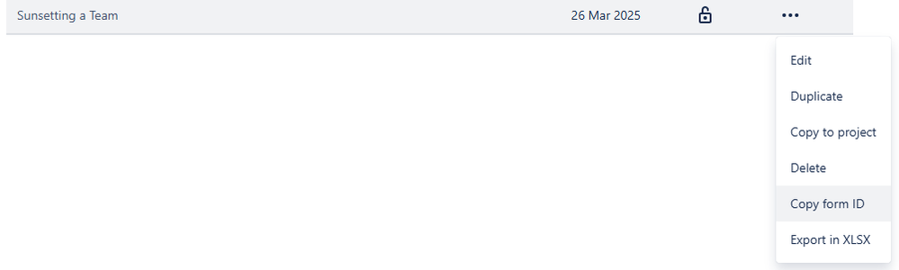

Tobias H
March 27, 2025
Hi all!
Just throwing this in here as I had not seen any communication about it.
You no longer have to fiddle about with the Inspector tool and search the network tab for the ID, you can simply press the three dots and "Copy form ID" to swiftly get the ID for any of your automation needs :D

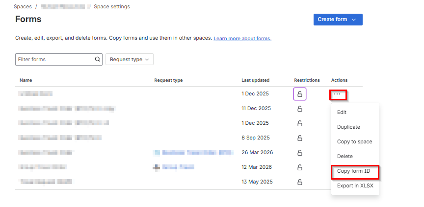

Kerli Suve
April 15, 2026
I believe there has been an improvement and when you are in Forms view, you can get ID from there. Easier compared to network tab or API's so if it is possible, maybe someone can update the knowledge base article too.
