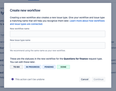

We will first prompt you to name the new workflow and new issue type that we will create for you. We recommend that your workflow and issue type have the same (or very similar names) so you know how they relate to each other.

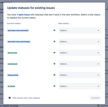

Once you’ve named your workflow and issue type, if you have any existing issues mapped to that request type, we will update them. This will require a status mapping if the new workflow doesn’t have all the statuses on your current workflow.

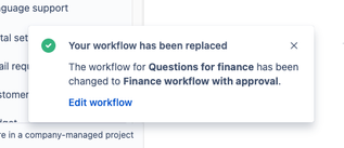

Once that is done, you’ll see a success notification on the bottom left and will be prompted to navigate to the workflow and edit it.

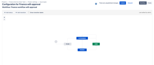

If you click on that link, you can further edit the workflow as needed.

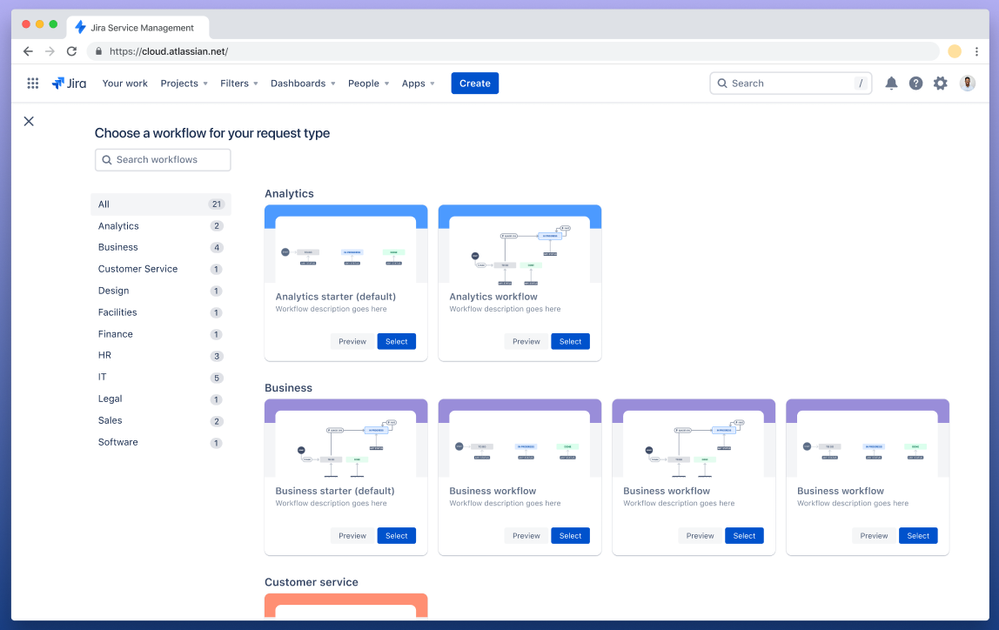

We are working towards workflow templates, which will allow you to select from a range of workflows designed for specific use cases. We are aiming to release this later this year (or early next year at the latest).
The catalog of workflow templates will cover use cases spanning from Finance to HR.
Select a workflow, preview it to understand whether it meets your needs or simply to get ideas about how you might want to configure your own workflows.
