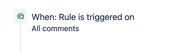

  1. The rule is triggered when the comment is added to the development project Picture1.png

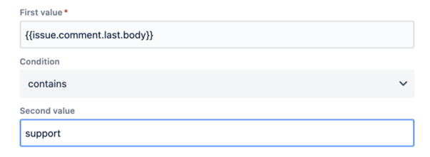

    You can make it triggered for comments with specific conditions to consider only specific comments or check if comment content contains a specific world as shown in the example below: Picture2.png

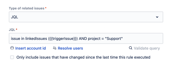

  2. Then you add a linked issues condition and send the same comment to the linked support ticket Picture3.png
    You can use JQL, as shown in the picture below, or you can filter by specific link type.

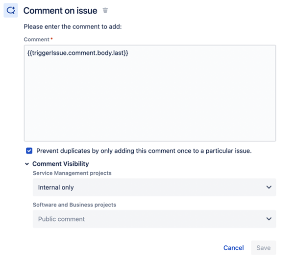

    Finally, you can configure if you want to show this new comment for the customers or make it internal only:Picture4.png

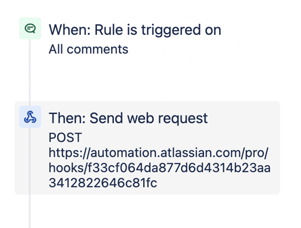

We will use webhooks to make it work. Сreate a listener rule in a support project. The rule will “listen” if there are any new comments added to the development project. As soon as it happens, the automation rule in the development project will send a webhook with the comment data in it, and the support project will “listen” to this webhook and take some further actions.

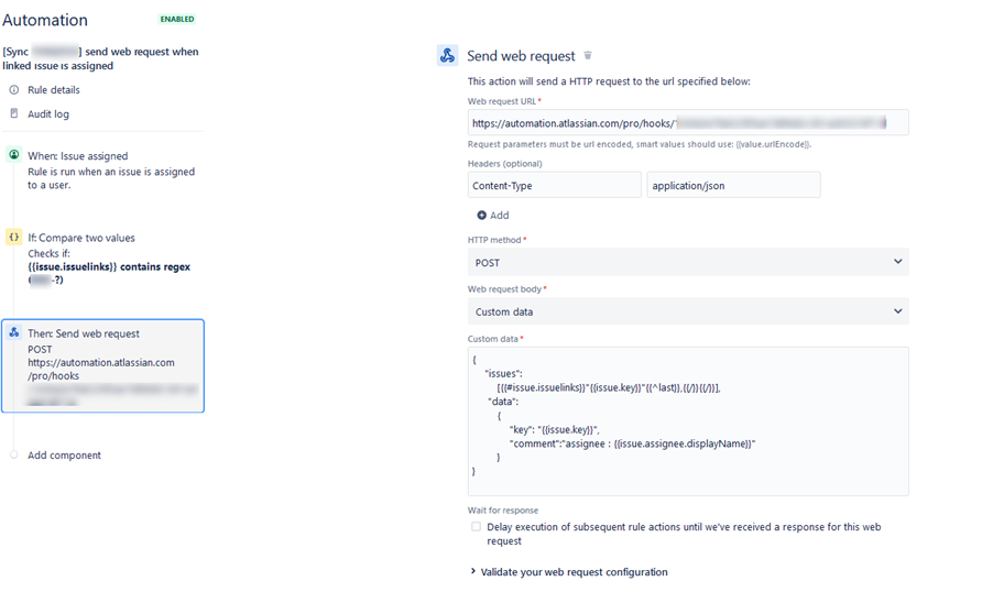

This is an example of the rule sending the webhook:Picture5.png
In the webhook you send the comment to the linked issue using the webhook custom data section:
    "issues":
        [{{#issue.issuelinks}}"{{issue.key}}"{{^last}},{{/}}{{/}}],
     "data":
            "key":"{{issue.key}}",
            "comment":"new comment : {{issue.comment.last.body.jsonEncode}}"

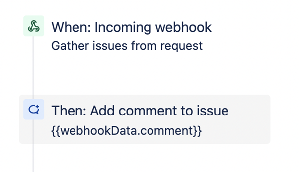

Here is an example of a ’listener’ automation rule which receives the webhook and adds a comment from the webhook data:Picture6.png

When the system is triggered by an assignee change, you can check if your development issue is linked to the support request. If it is, it sends webhook custom data that is related to your event — in your case new assignee name — as you can see in the example below:
