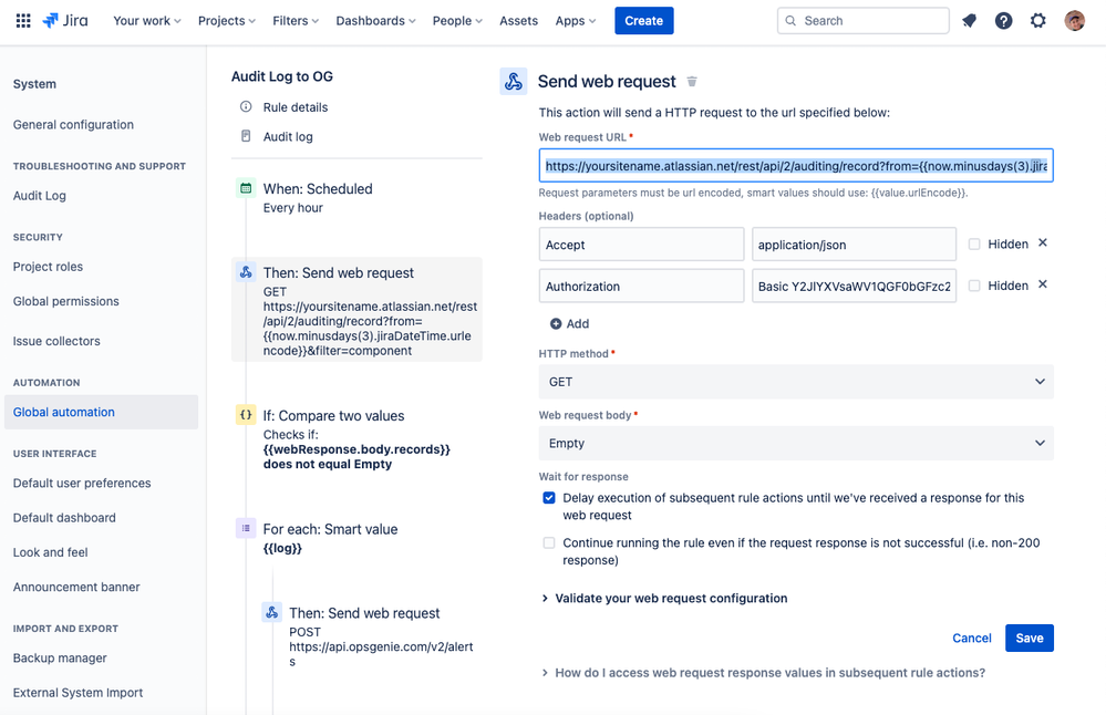

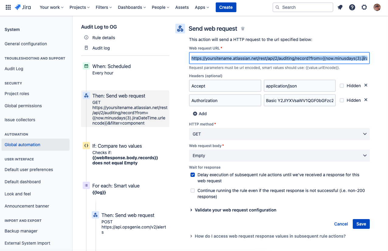

  • Create a Scheduled Automation Rule using the Scheduled Trigger to run every 1 hour (as an example)

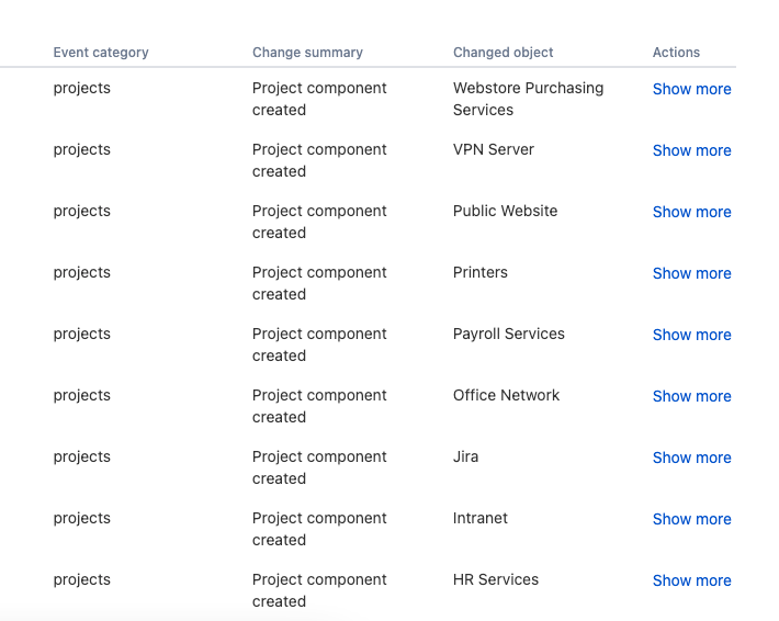

  • Create a GET Web Request Action using Basic Authorization and Accepting JSON. This will use a Web Request URL similar to the code below. Please note: The ?filter=component is used to determine the type of Audit Log record that is going to create an Opsgenie Alert. So you can change component to another keyword found in the Audit Logs. To add, this value is based on a String value found in the Change Summary of the Audit Logs in Jira:

https://yoursitename.atlassian.net/rest/api/2/auditing/record?from={{now.minusdays(3).jiraDateTime.urlencode}}&filter=component
  • So for informational purposes the {{now.minusdays(3) will look at the time now, and back 3 days in time and use the Jira Date/Time format from .jiraDateTime.urlencode}} which will format the data and encode it correctly as we are using smart value variables:

  • Afterwards, we setup an Advanced compare condition with the value of: {{webResponse.body.records}} that Does Not Equal Empty to ensure the Rule creates an Opsgenie Alert, only when there is content in the Web Response Body.
  • Then we will create a Smart Value Variable Advanced Branch of: {{webResponse.body.records}} and name it log, so we can later reference the web response body in the POST API call to Opsgenie. So move the Audit Log data from the GET to the POST simply by referenced the web request response from the initial action.

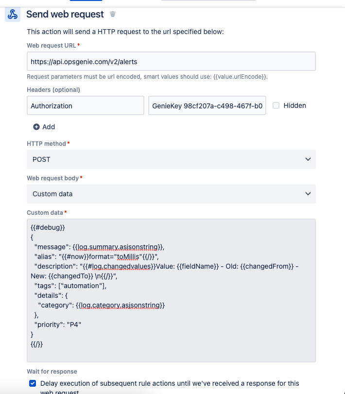

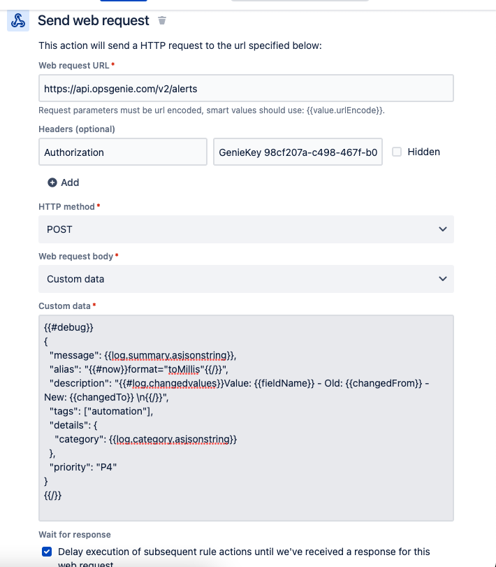

  • Lastly, we will setup the POST Web Request Action to Opsgenie using the Alert API, using the GenieKey (API Key) for the Default API integration in Opsgenie. This will have a Web Request URL of: https://api.opsgenie.com/v2/alerts and have Headers of: Authorization GenieKey APIKEYFROMOPSGENIEINTEGRATION
  • This POST Web Request Action will use Custom Data, formatted like this, using values found in the Alert API in Opsgenie.
    • We are first debugging the data to log it to the Audit Log of the Automation Rule, and then including the formatting of the content to send into the Alert, based on the fields available in the Alert API
{{#debug}}
"message": {{log.summary.asjsonstring}},
"alias": "{{#now}}format="toMillis"{{/}}",
"description": "{{#log.changedvalues}}Value: {{fieldName}} - Old: {{changedFrom}} - New: {{changedTo}} \n{{/}}",
"tags": ["automation"],
"details": {
"category": {{log.category.asjsonstring}}
"priority": "P4"

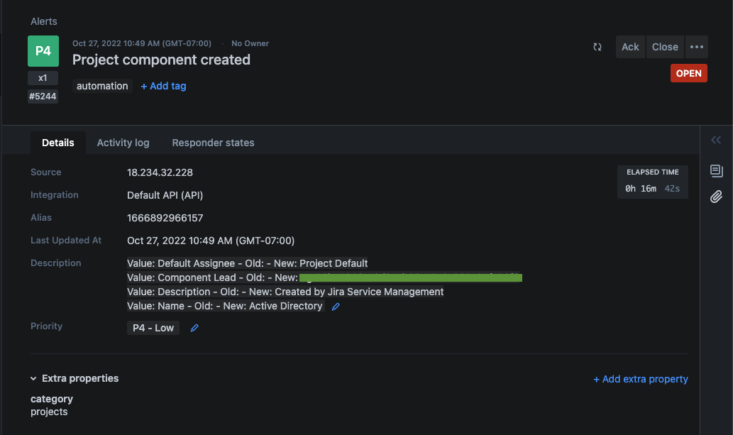

  • Once this runs on the Scheduled timeframe or is manually ran, it will create an Alert that will look like the following:
