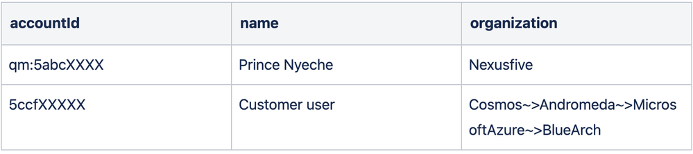

Adding customers to JSM organizations
To perform this operation, you will need to prepare your data file in the below format. It is crucial that your CSV file is structured in the below manner having 3 columns, so the app can be able to perform the bulk operation. The name part isn’t used but it helps to nicely represent your users during the file formulation. Use this delimiter ~> for adding customers to multiple organizations at the same time.
Simply upload the above file with its data content to have the users added to the specific organizations. Please note that organizations are case sensitive, so ensure that you’re using the right name at all times. Prior to submission ensure you set the “Customer selection” to “JSM Organization”.

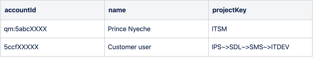

Adding customers to Jira service management project
A similar data structure as above is required to add customer users to any JSM project. A 3 column CSV file is required with the below structure.
Once your file above is prepared, simply upload the file and set the option for customer selection to “JSM Project” prior to submission. Use this delimiter ~> for adding customers to multiple projects.
Doing the above will update the records of your customers on your cloud instance. Please note when adding customers to organizations, sometimes it can take up to a minute for some of the users to sync properly. Performing a removal of customers from organizations or projects uses the same type of file format as above. So if you want to remove those customers, please use the same file structure.

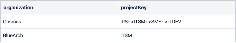

Adding organizations to Jira service management projects
Performing bulk addition of organizations to specific Jira service management projects involves you knowing the exact string for the organization and listing out the project keys that you need those organizations added to. Create a CSV file having only two columns as shown below. Use this delimiter ~> for adding organizations to multiple projects.
Once you’re done with your file formulation, simply upload the file and the organizations will be added to those projects. Similar action should be taken when you want to remove organizations from projects.
