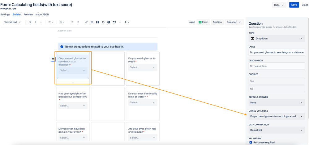

    • It will need to link all form fields to custom Jira fields (this is necessary for the A4J to be able to get the answers from the fields):Screen Shot 2021-10-13 at 17.00.23.png

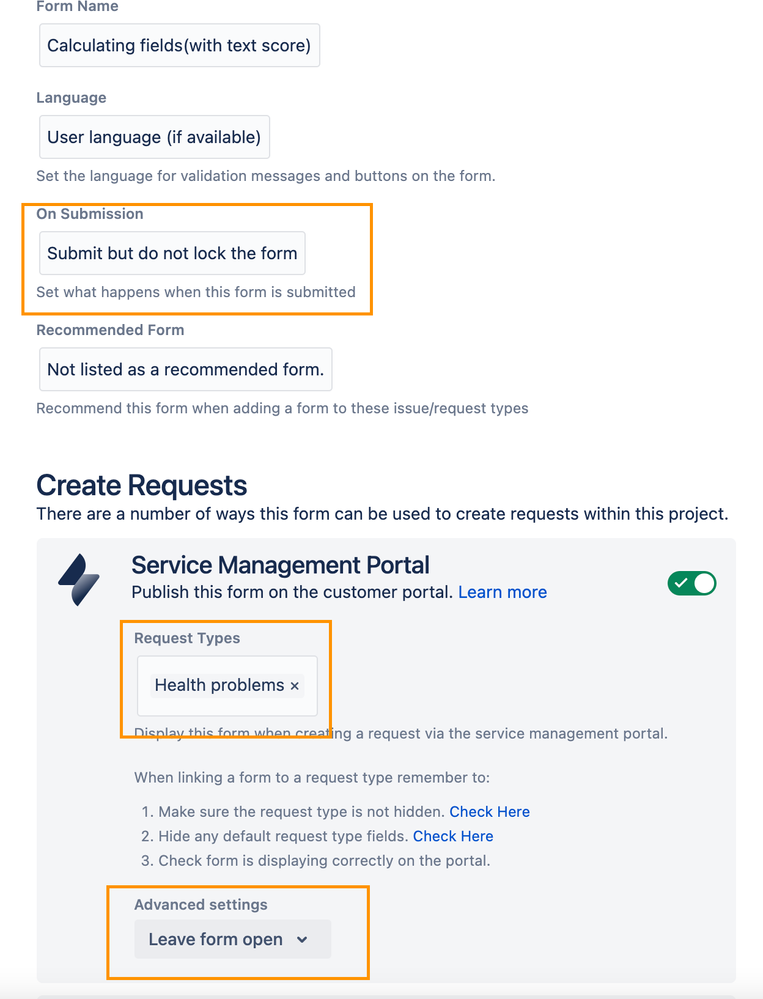

    • And it’s will be necessary to leave the form open on issue creation (this is necessary for have an communication between ProForma and the A4J):Screen Shot 2021-10-13 at 17.05.36.png

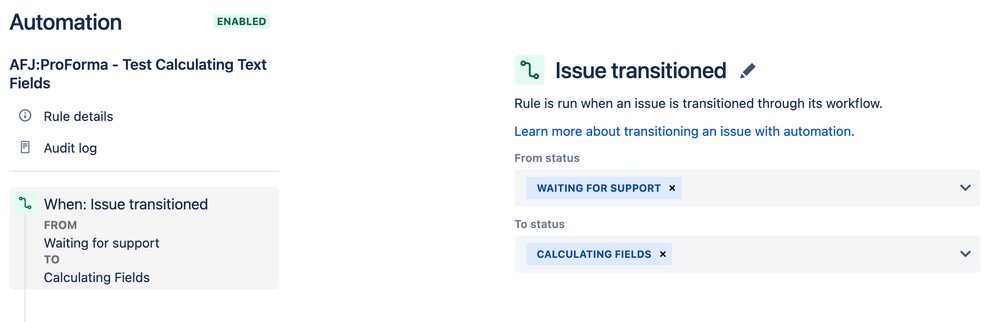

      • It’s only possible to trigger this automation rule by an 'Issue transitioned' status, another one will doesn’t work because of a time limitation between ProForma and A4J:Screen Shot 2021-10-13 at 17.14.52.png

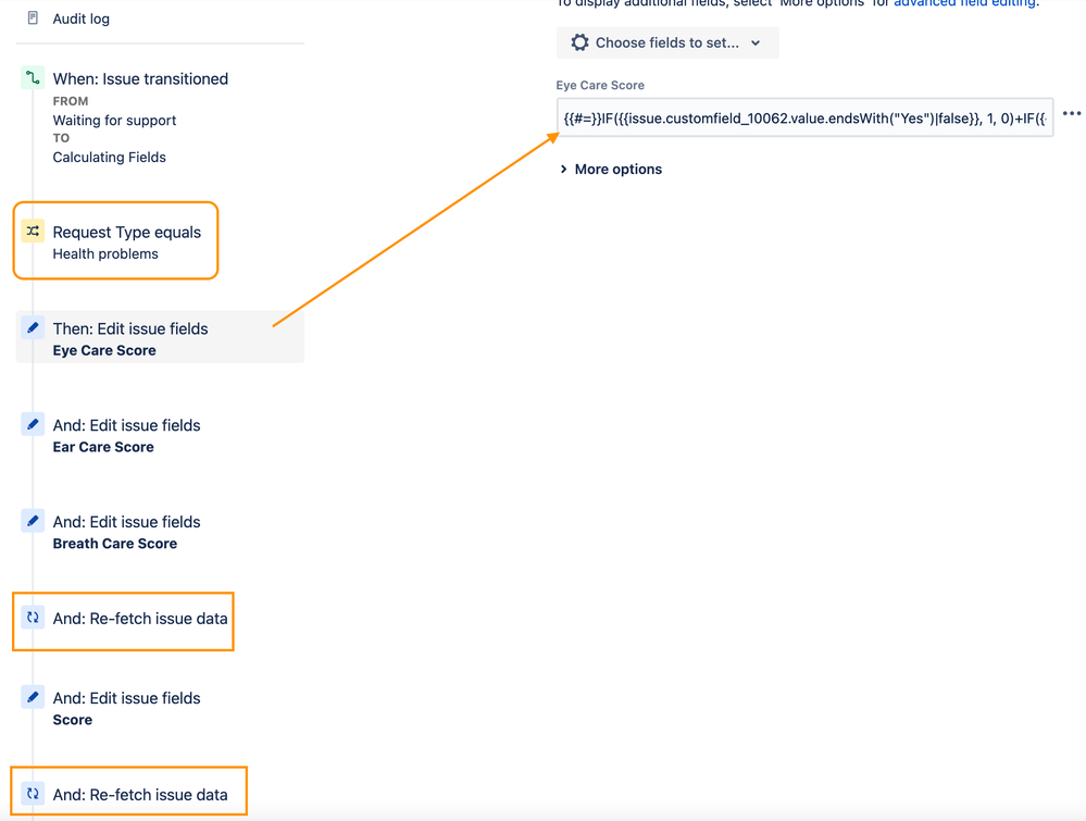

      • Specify which issue type the automation rule will work. Using Smart Values it’s possible to calculate the options selected by a customer and made the sum of them (also note the defined Re-fetch actions):Screen Shot 2021-10-13 at 17.24.26.png
      • So the icing on the cake for calculating text fields options like 'Yes' or 'No' it’s here:
        {{#=}}IF({{issue.customfield_XXXXX.value.endsWith("Yes")|false}}, 1, 0)+IF({{issue.customfield_XXXXX.value.endsWith("Yes")|false}}{{/}}
      • In the edit logs I used three for calculating the values of the section and one for sum the total:
        - First section:
        {{#=}}IF({{issue.customfield_10062.value.endsWith("Yes")|false}}, 1, 0)+IF({{issue.customfield_10063.value.endsWith("Yes")|false}}, 1, 0)+IF({{issue.customfield_10064.value.endsWith("Yes")|false}}, 1, 0)+IF({{issue.customfield_10065.value.endsWith("Yes")|false}}, 1, 0)+IF({{issue.customfield_10066.value.endsWith("Yes")|false}}, 1, 0)+IF({{issue.customfield_10067.value.endsWith("Yes")|false}}, 1, 0){{/}
        - Second section:
        {{#=}}IF({{issue.customfield_10068.value.endsWith("Yes")|false}}, 1, 0)+IF({{issue.customfield_10069.value.endsWith("Yes")|false}}, 1, 0)+IF({{issue.customfield_10072.value.endsWith("Yes")|false}}, 1, 0)+IF({{issue.customfield_10073.value.endsWith("Yes")|false}}, 1, 0){{/}}
        - Third section:
        {{#=}}IF({{issue.customfield_10075.value.endsWith("Yes")|false}}, 1, 0)+IF({{issue.customfield_10076.value.endsWith("Yes")|false}}, 1, 0)+IF({{issue.customfield_10077.value.endsWith("Yes")|false}}, 1, 0)+IF({{issue.customfield_10078.value.endsWith("Yes")|false}}, 1, 0)+IF({{issue.customfield_10079.value.endsWith("Yes")|false}}, 1, 0)+IF({{issue.customfield_10080.value.endsWith("Yes")|false}}, 1, 0){{/}}
        - Total sum:
        {{#=}}{{issue.customfield_10071}}+{{issue.customfield_10074}}+{{issue.customfield_10081}}{{/}}
        Note: To find the custom field ID please take a look at this documentation. Also, the values 1 and 0 can be changed for any value that you wish.
