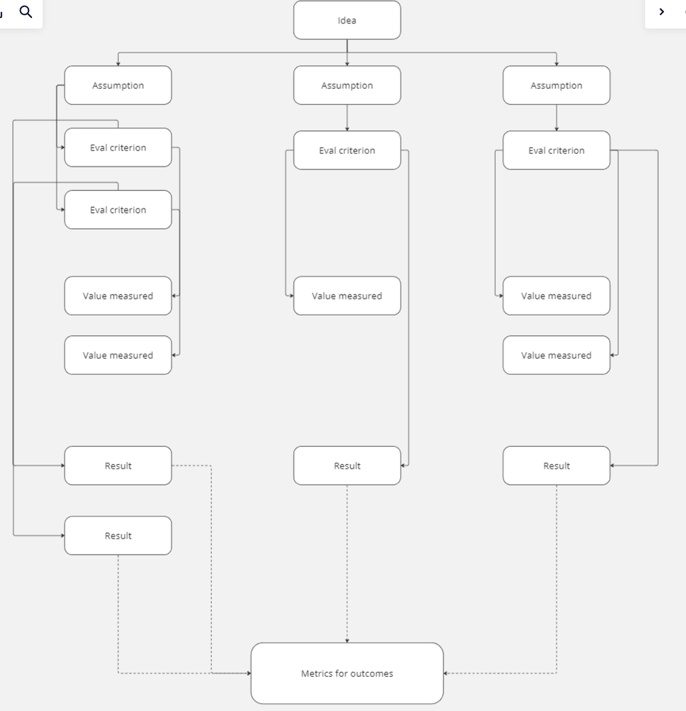

When conducting assumption tests/experiments, I need to record the assumptions we test and what kind of evaluation criteria apply to each. Then I need to record the result (did it pass the criteria or not).
Has anyone found a way to collate those across ideas?
My issue is this:
I tried to create a view but that didn't work out because I don't know how I could have the idea show up multiple times in the table. Because the JIRA key is the unique identifier and the underlying logic seems to be that in the table each key can show up once. That means that if I have 3 assumptions I need to test for an idea, I can't have the 3 assumptions show up on separate lines with the same idea.
Here's the structure I need:
To make a full circle, then in case the idea will be implemented (if the assumption tests pass) its metrics should feed into the outcome(s). Because how else can we tell that we've moved the needle.
Maybe there is something I don't know or am overlooking. Pls halp :D

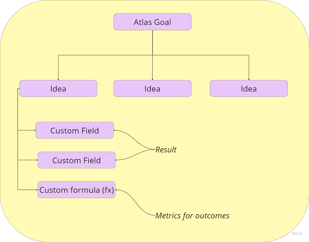

Hello @Helena Jeret-Mäe! I want to share a different perspective.
Did you know you can link Atlas Goals with Jira Product Discovery? Just raise a request to Atlassian support to get this integration on your instance.
What if you use an Atlas Goal as the top-level parent, and the use Ideas as Assumptions. If you think about it, ideas are about testing hypothesis, and you are trying to reach a goal with these ideas.
Maybe you can use custom fields (number, rating) for Value measured and the results, and a Custom formula (fx) field for the outcomes.
This way, you can have all your Ideas grouped by Atlas Goal (in fact, you can just use the Goal field, but the Atlas integration is really cool).

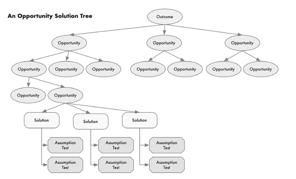

I'm following the continuous discovery process as taught by Teresa Torres. In that methodology everything flows from the outcome. We identify opportunities and sub-opportunities and once we've prioritized them, we will develop solution ideas. So for me "ideas" are pretty specific solutions that are tied to an opportunity. I have organized JPD so that each idea is a solution and a number of solutions can be tied to the same (sub)opportunity.
Once the assumptions have been mapped for each solution, we will choose the critical ones to test. And we may also iterate on the test. So there can be quite a bit of work before we move an idea from discovery to refining the solution and then delivery.

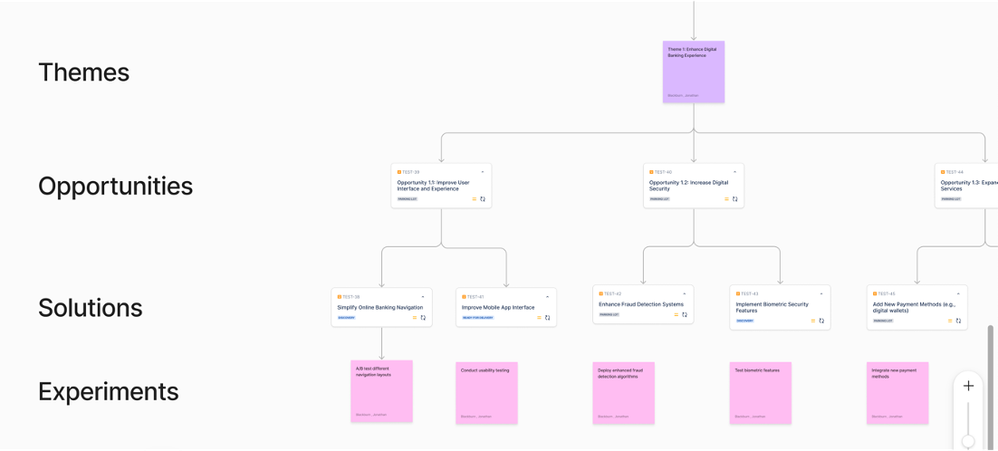

I believe a lot of the power with OSTs is around the visualization - I see the WHOLE opportunity space and I see where I am focusing on. So I've tried using Miro/Figjam integrations with Jira/JPD to allow you to view the tree and latest data from Jira/JPD.
The lines here have no integration with Jira issue relationships but that might be possible in Miro, I just haven't invested in testing that out.
The way I've done it is to manually create the whole OST using stickies. Then only a select few we go and create in JPD via the "convert sticky to issue" widget.
What you miss with this is that you can't bring in Goals yet - only issues. Also, the whiteboard integrations are not really set up for JPD so I think you'll be limited in the fields you can see beyond the core ones (e.g. summary, description, status).
