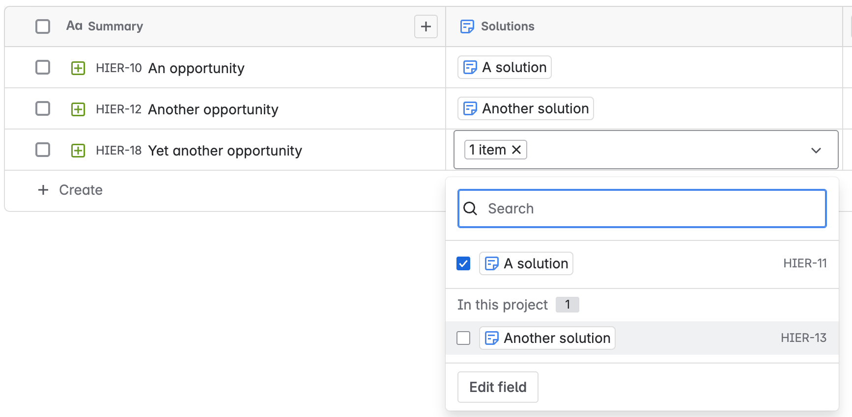

In the Free and Standard plans, Jira Product Discovery only supports a flat model, where every idea is at the same level. As part of the Premium plan of Jira Product Discovery we’ve introduced a feature that lets you create custom product hierarchies - for example this view that shows Opportunities, Solutions and Experiments and how they ladder up. In a board view:

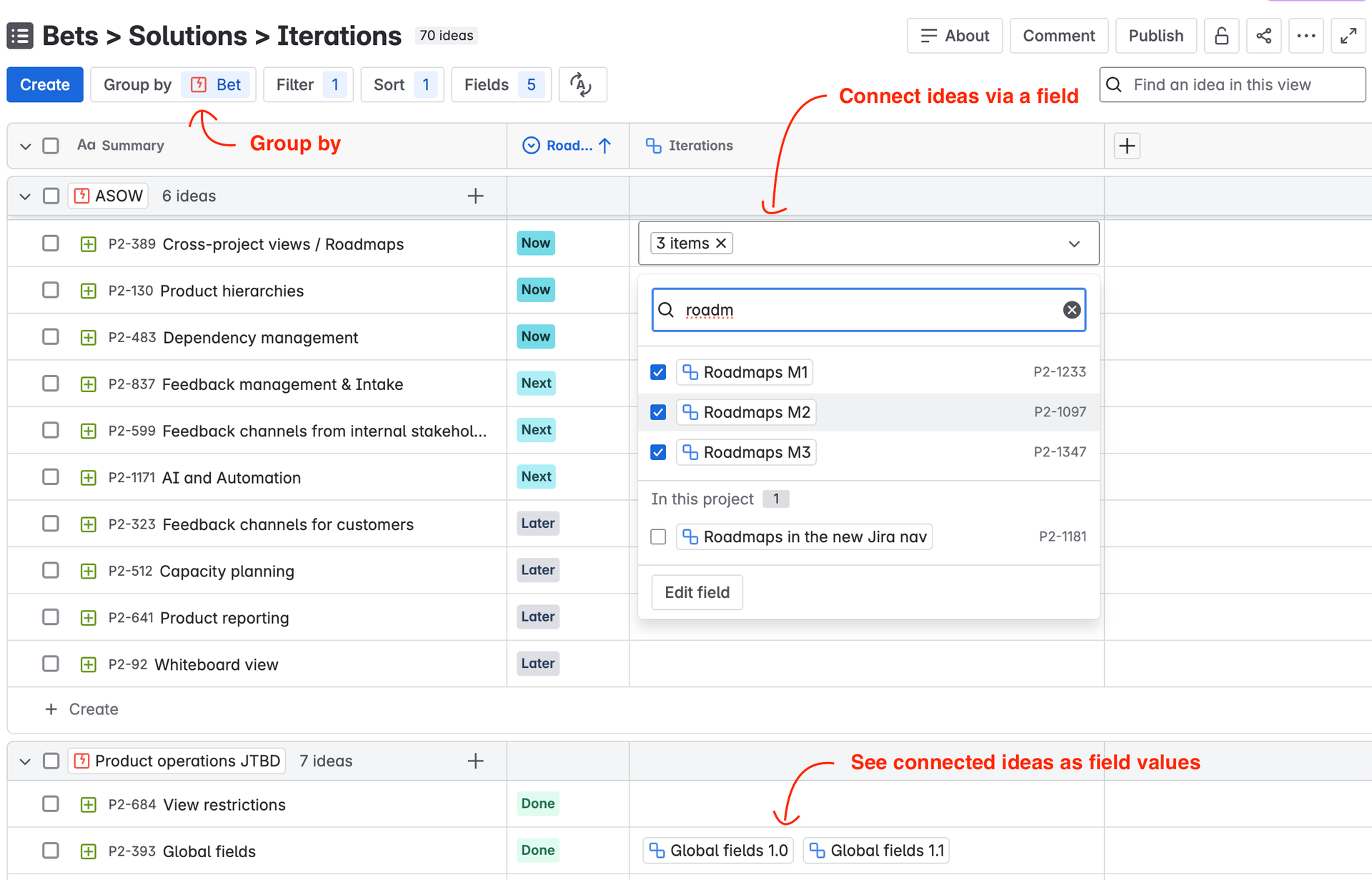

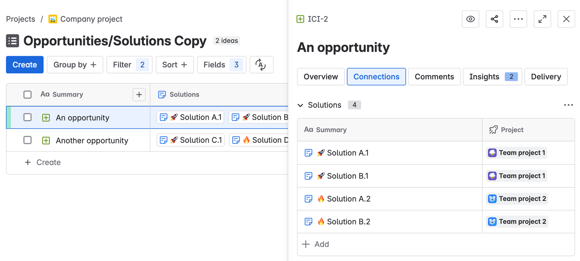

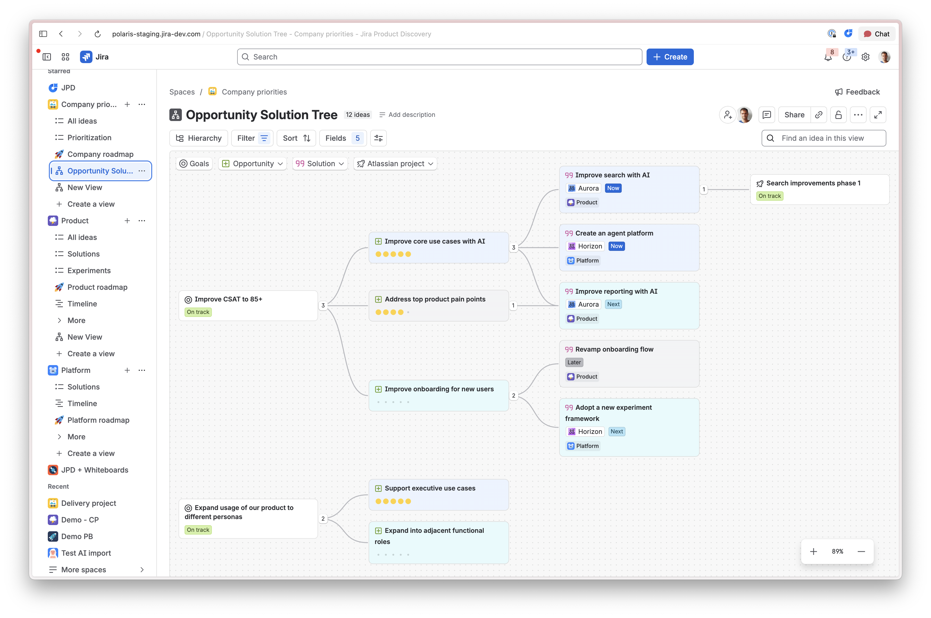

Or in the tree view:

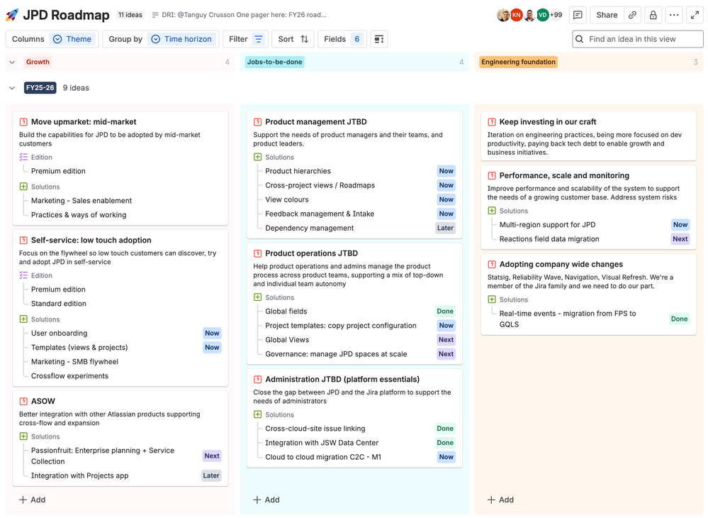

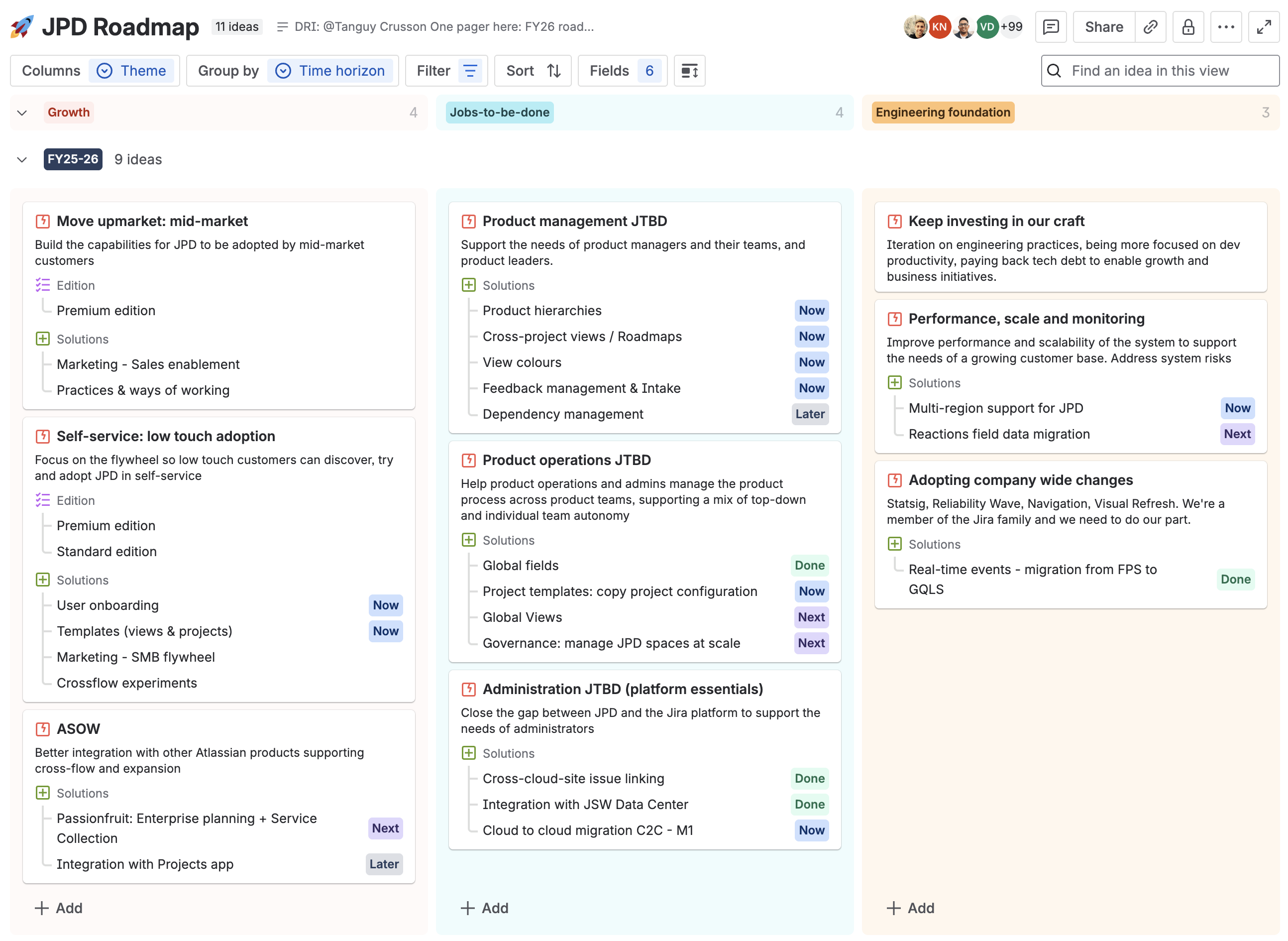

And this is a view we use in the JPD space where the JPD team manages the JPD roadmap šŸ™‚
The following demo walks you through use cases, how it works and how to set it up in your space:
Here's an shorter version so you can grasp the concept in 2 minutes.
How it works
In Jira Product Discovery you have spaces, spaces have ideas, ideas have fields, fields have values, and you can create views that help you visualize ideas based on field values. This system works with different types of fields: select, multi-select, rating, votes, etc.
Here we have introduced two new concepts so you can create hierarchies:
  • Custom Types - so you can have different types of objects in your discovery spaces - e.g. Opportunity, Solution, Experiment - instead of just Ideas.
  • A new type of field: Connection - which lets you connect ideas of different types. The easiest way to think about this: ideas can be field values for other ideas. For example an Opportunity called ā€œAn opportunityā€ can have the field value ā€œA solutionā€ for its field ā€œSolutionā€.
  • Integration of these fields into JPD views: you can use Connections fields as you would any other field in JPD to create custom views. For example in a list view:

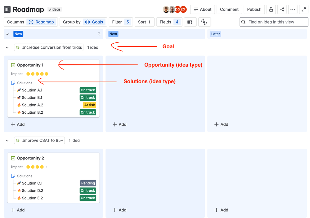

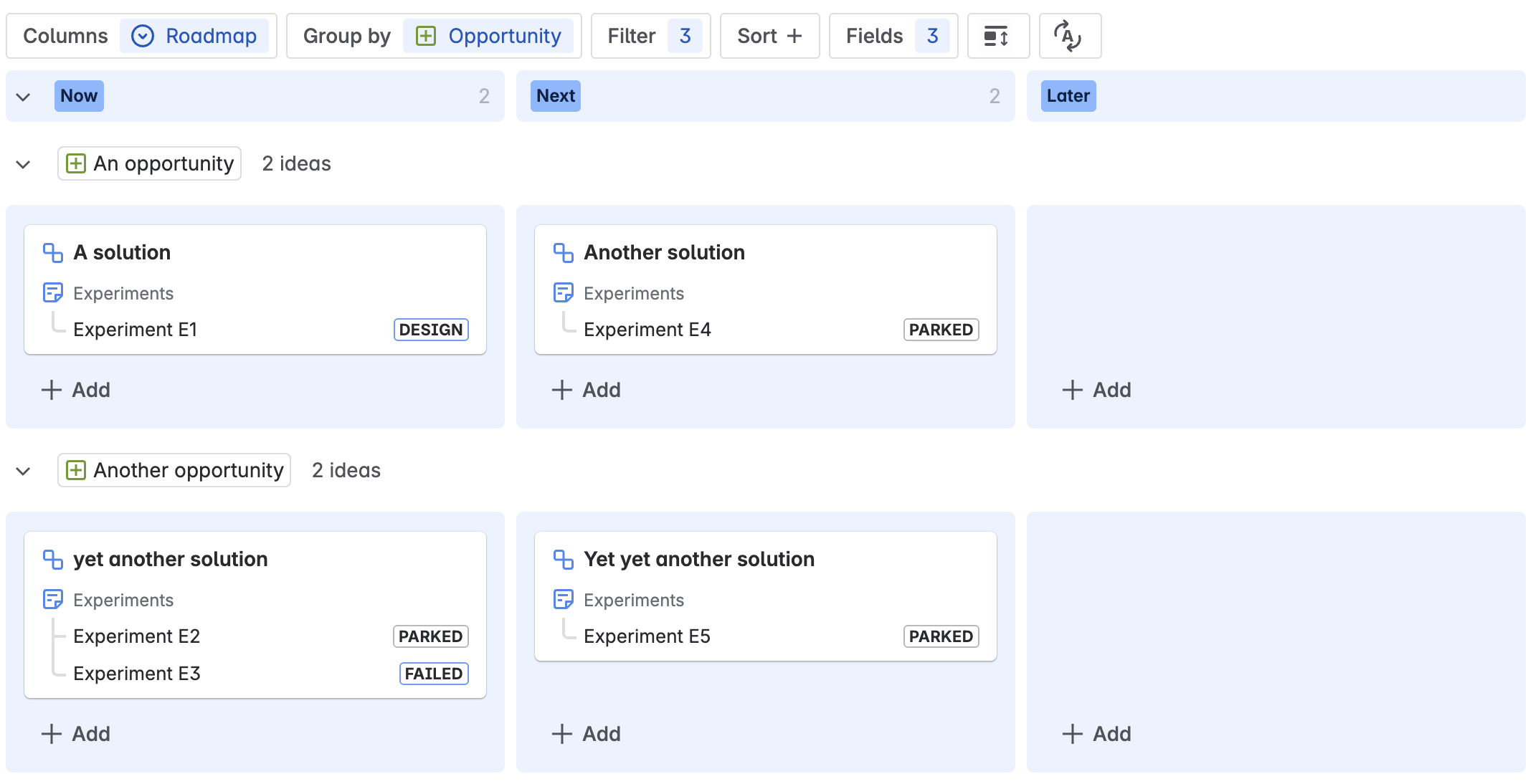

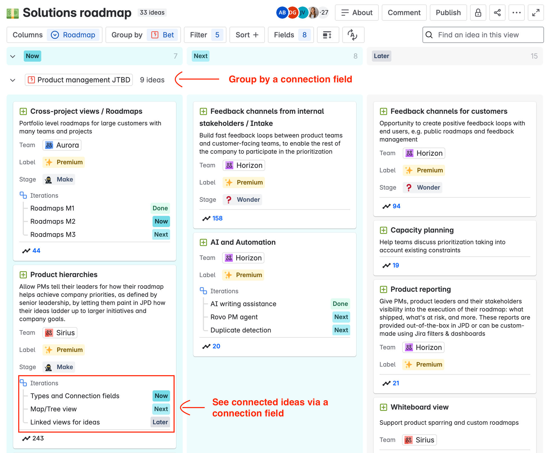

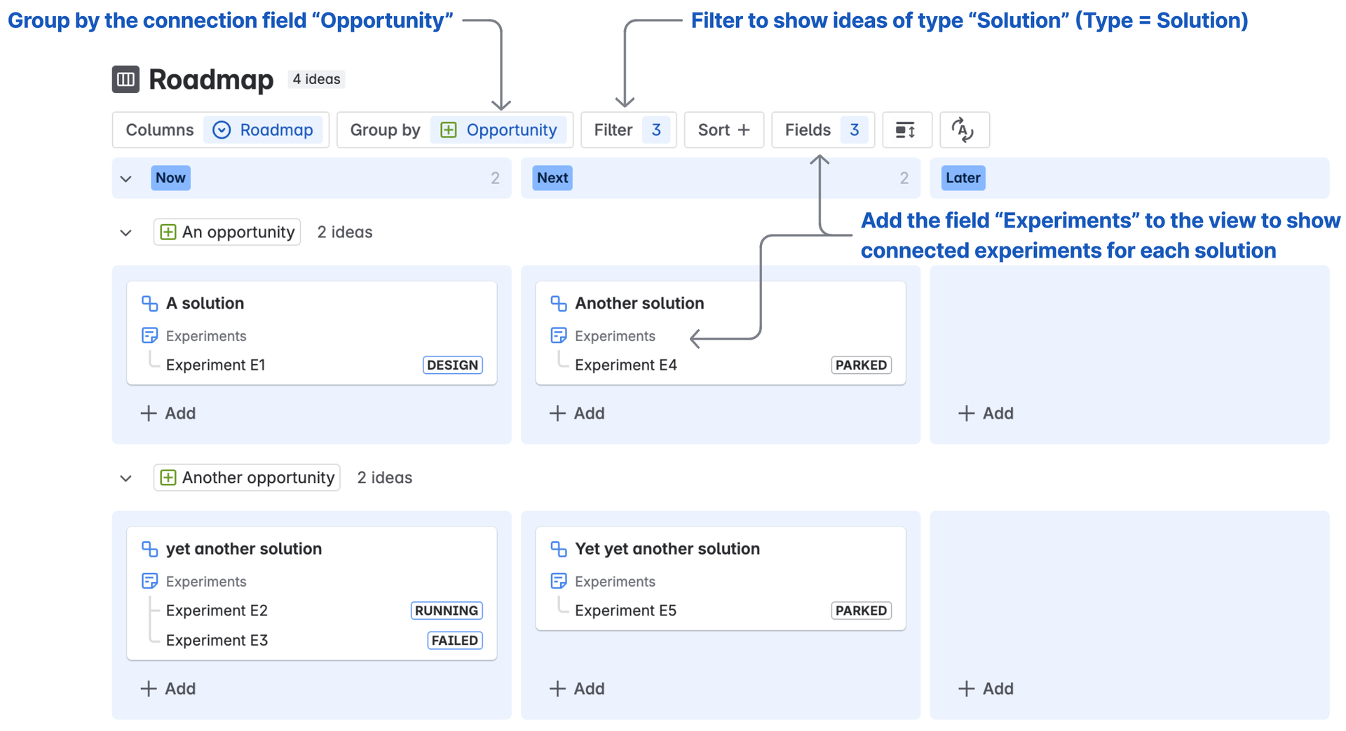

Or in a board view:

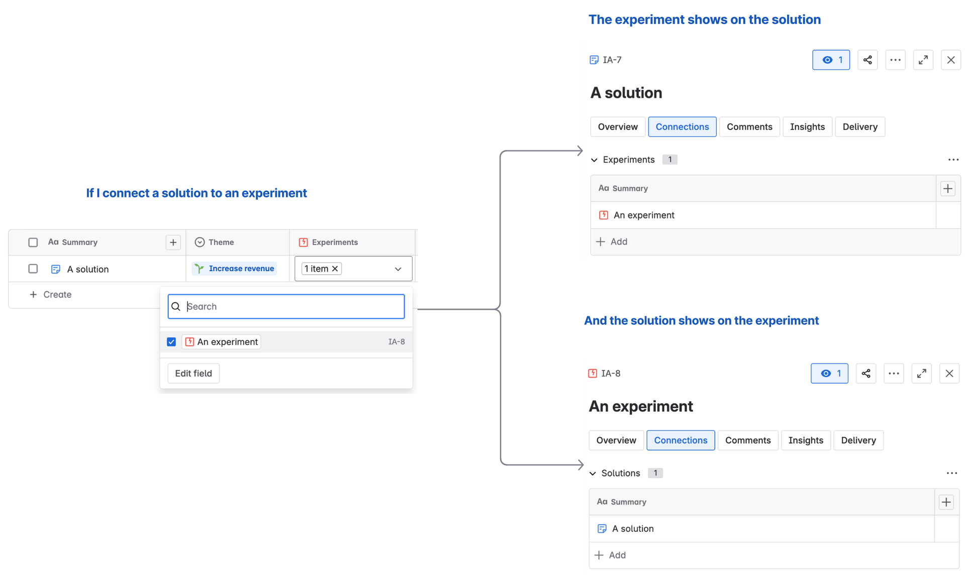

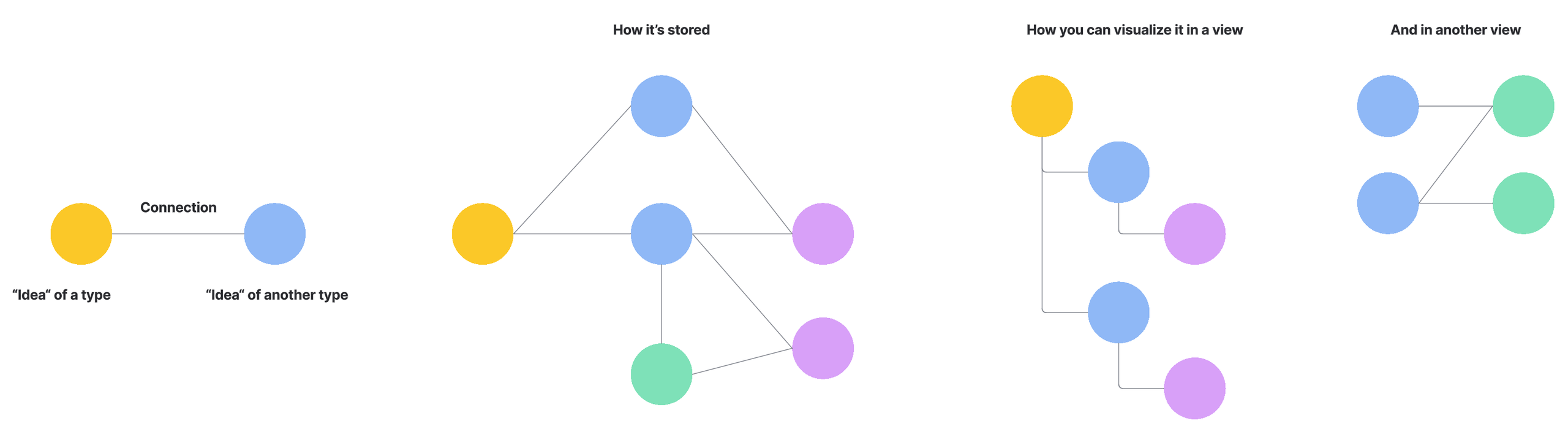

Under the hood connections between ideas are stored as Jira issue links. It’s still a flat model, where all ideas are at the same level in a graph, but you can use views to visualize them in a hierarchy:
When you connect ideas via a connection field, this connection will show on both ideas - it’s bi-directional:
Connection fields behave a bit differently to other JPD field types (select, multi-select, etc.) in that they don’t really store any value - the connections between ideas are stored as Jira issue links.

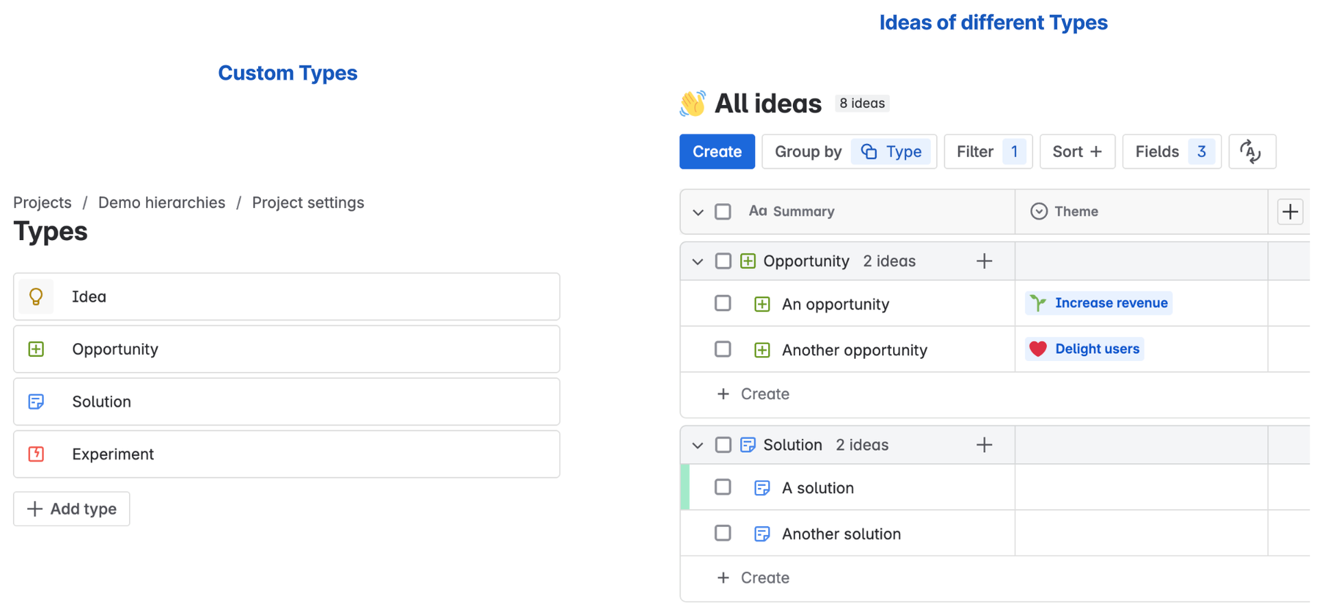

Create types and connection fields
You need to create one type and one connection field for each type. For example if you have 2 types, Opportunity and Solution, the steps are:
  1. Create a Type ā€œOpportunityā€
  2. Create a Connection field ā€œOpportunityā€ pointing to that Type
  3. Create a Type ā€œSolutionā€
  4. Create a Connection field ā€œSolutionā€ pointing to that Type
Here’s a demo for how to do that.
Here are a few things you should be aware of:
  • Make sure you create one Connection field for each type - otherwise if you connect 2 ideas the connection will only show on one of them, not both. There’s no point creating more than one Connection field for each Type - because it stores connections as Jira issue links, if you connect ideas via one Connection field, it will also show in any other field pointing to the same Type
  • Pro-tip: You can create connection fields as Global or Space fields, depending on your overall set up. It’s OK if you don’t get it right from the first go: you can create a Global field, add it to the space, and delete the space field - and ideas will still be connected as before.

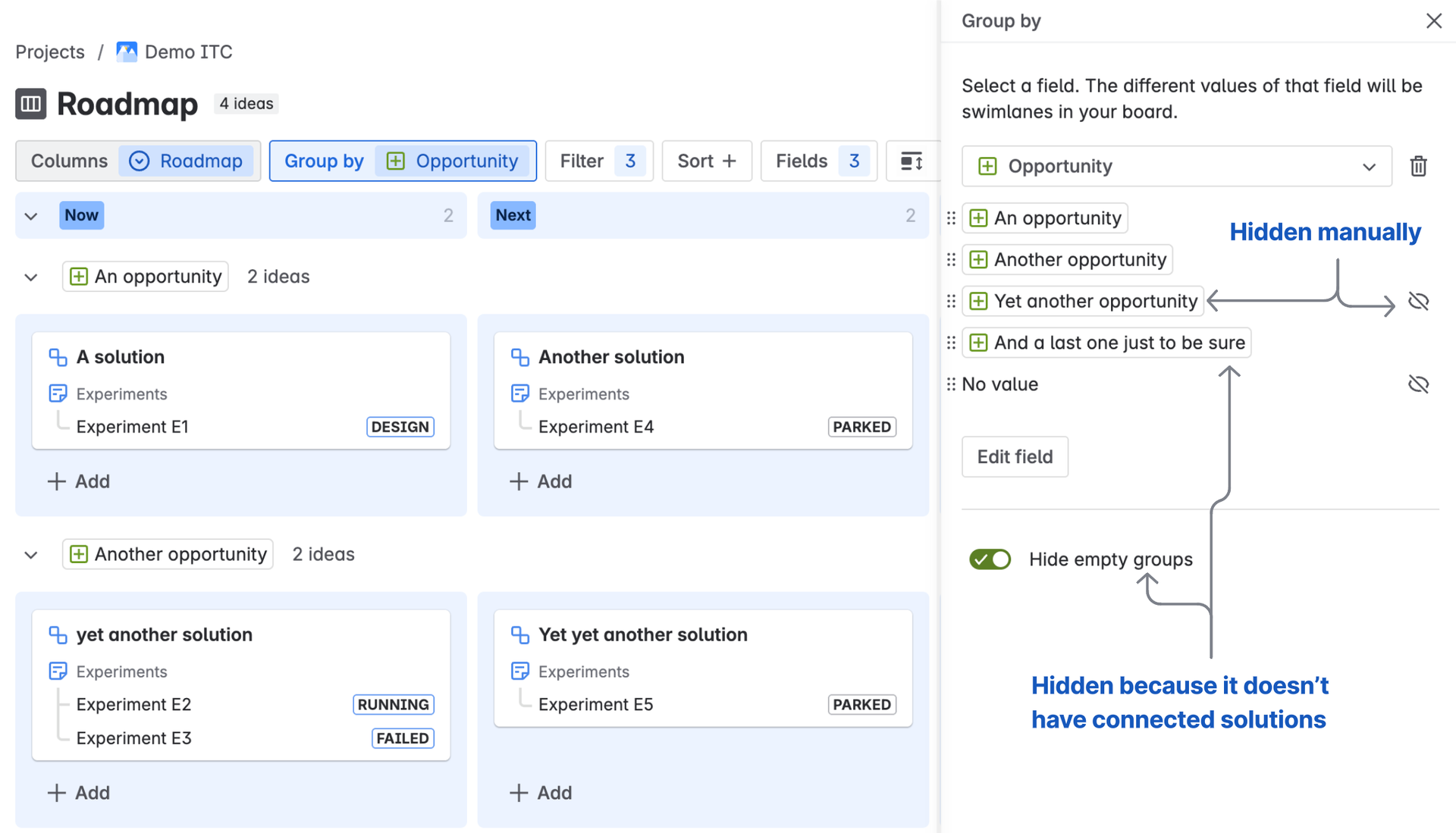

Configure views
You can then set up a view to show up to 3 levels of ideas, e.g. Opportunity/Solution/Experiment:
To do so:
  • Create a filter to only show ideas of a specific Type (Solution) - this ā€œfocusesā€ the view on Solutions
  • Group by a Connection field (Opportunity) - it shows Opportunities as ā€œParentsā€ of Solutions
  • Add a Connection field to the view (Experiments) - it shows Experiments as ā€œChildrenā€ of Solutions
Watch this demo for how to reproduce this view.
Understanding filtering
You can filter ideas at 3 levels:
  • Ideas you are grouping by (e.g. Opportunity): you can select which ideas to show as groups, the same way you would when grouping by any other field type
    • Note: as of 9 December 2025 you can also define a filter in the group by menu, to filter connections used to group based on field values.
  • Ideas that are shown on the view (e.g. Solution)
  • Ideas that show in a connection field (e.g. Experiments) - you can filter them using field values (like for ideas on the view) or by matching field values for groups and columns: see this 3min demo video to understand how that works

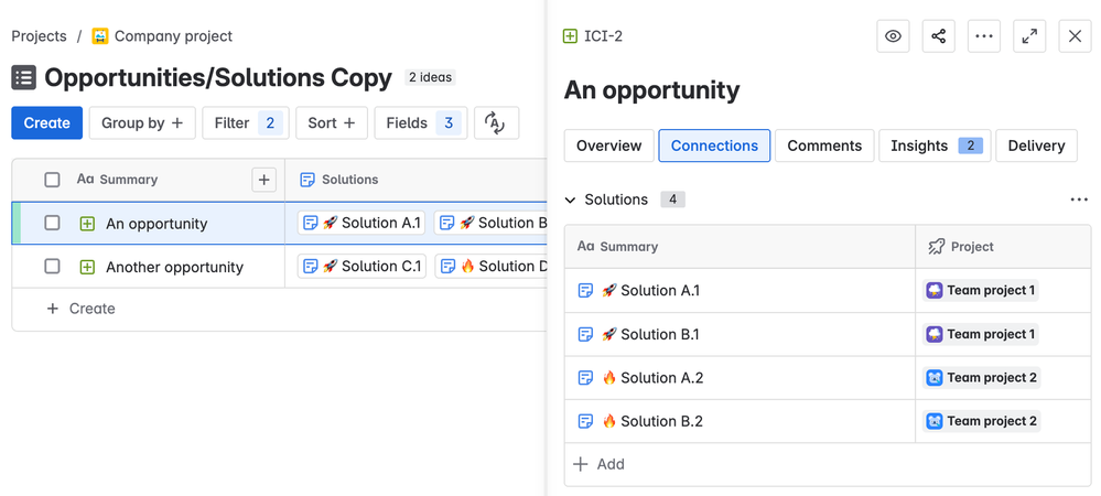

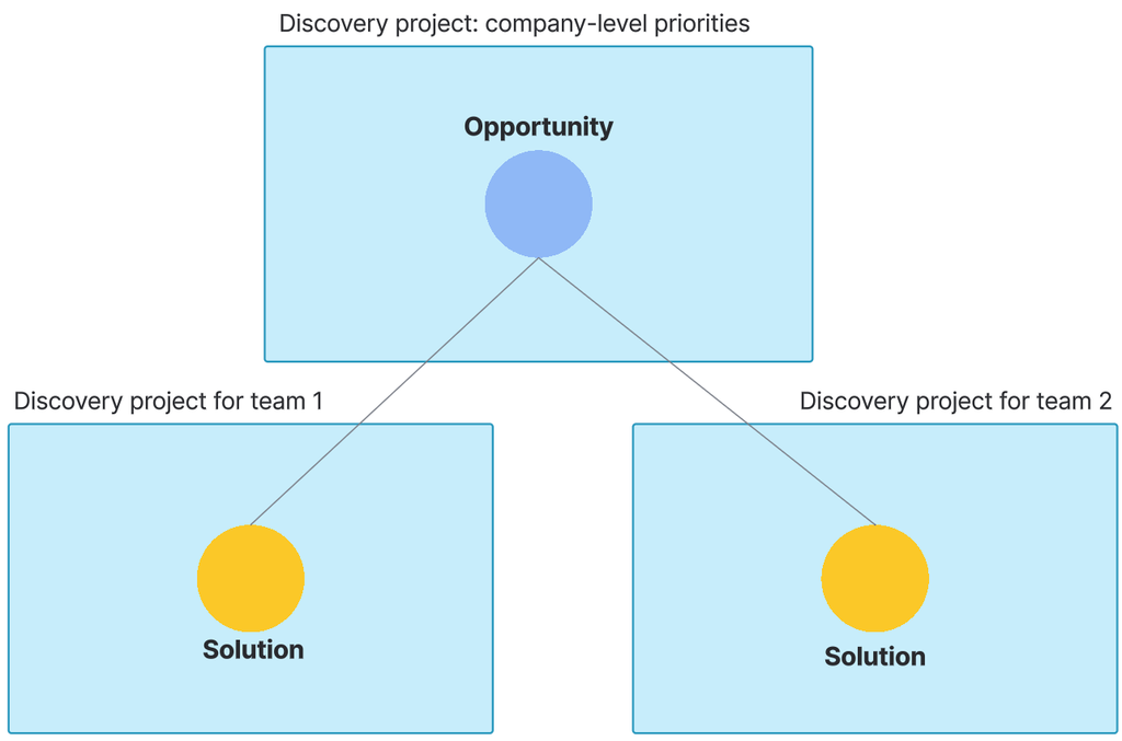

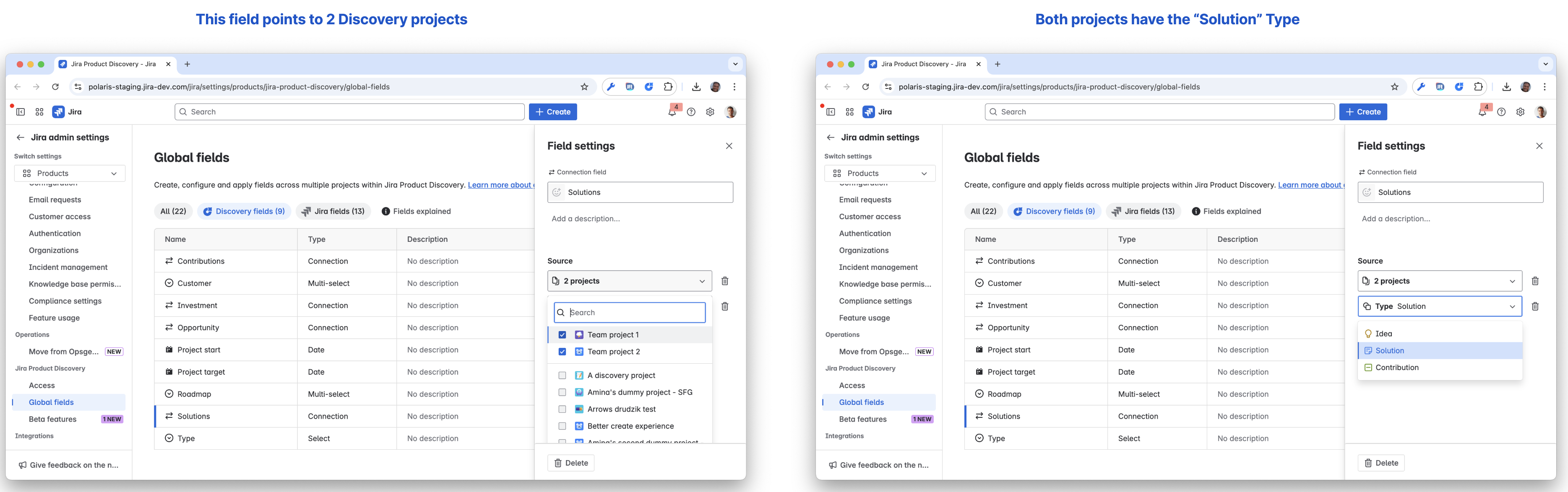

Connect ideas from different spaces
You can connect ideas from different Discovery spaces. Let’s take the example of a set up where you have:
  • A Discovery space that has opportunities at the company-level
  • 2 Discovery spaces, one for each team, that have solutions
  • And you want solutions that teams work on to be connected to company-level opportunities
You can achieve this with connection fields:
In this sample view in the company space, you can see how opportunities connect to solutions from the two separate team spaces:
Here’s a demo for to replicate this set up:

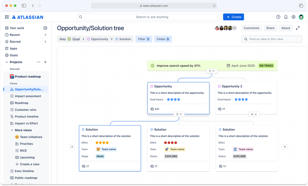

Using the new tree view
As of 22 June 2026 we've introduced the tree view to help you better visualise your hierarchies in JPD:
See instructions for how to use it here.

Thanks @Amin Fadul ! It's already integrated with Goals. You can use Goals by adding the "Goals" field to a view and using it exactly as you would a connection field. We're currently making changes so the ideas you connect to goals also show on the goal itself in the Home experience, not only in Jira Product Discovery
Tanguy Crusson
May 12, 2025
@Amin Fadul here's an example of what it looks like: Screenshot 2025-05-12 at 12.16.10.png

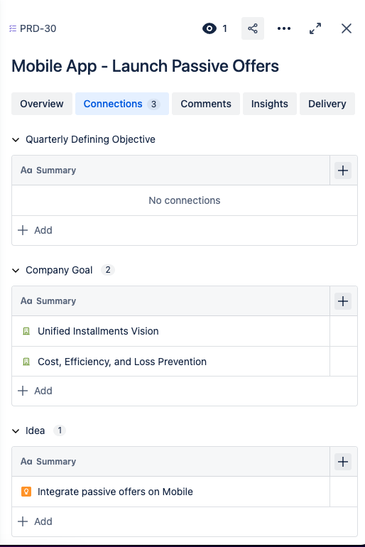

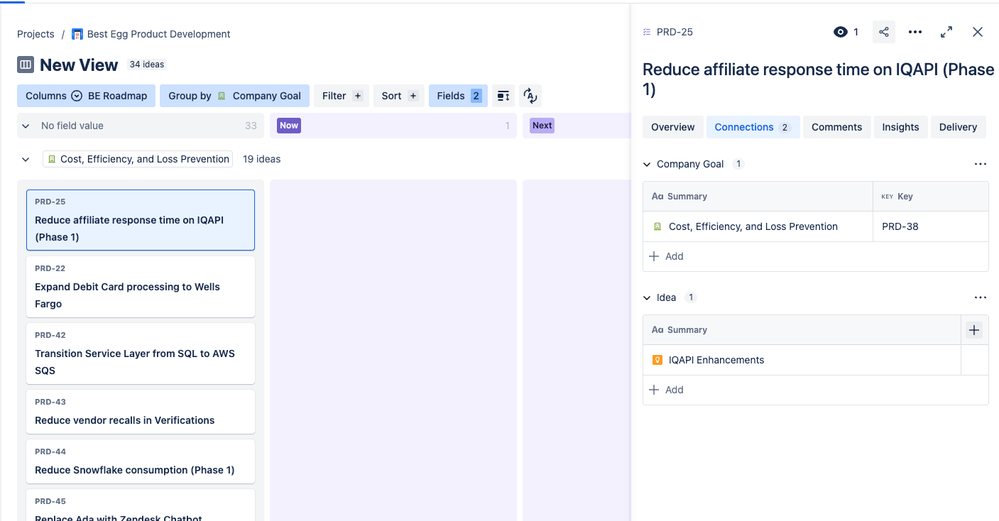

Thank you @Tanguy Crusson - I am able to create different issue types and connect them, but am still not seeing a way to create the display you have where Experiments gets connected to the Solution. I would like to show the Idea as a title under the Workstream card (so "IQAPI enhancements" would have a line drawn to the Reduce affiliate response time. Here's what I am seeing:Screenshot 2025-05-14 at 4.22.26 PM.png
I'm curious what I should do differently?
Antoni Abella Vendrell
May 14, 2025
@Stefanie Ramsay , I've been using it for a while, you just need to add the "connection" field you want to show in the card in the list of "Fields" for the view.
It seems that you are filtering by "Company Goal", grouping by "Now/Next/Later", now you should just add in the Fields view the "idea" connection field. @Tanguy Crusson shows it quickly on his explanation video above, maybe worth going over it slowly as it's easy to miss.
P.s. I'm assuming that you created a connection field named "Idea" that connects to idea type "idea"

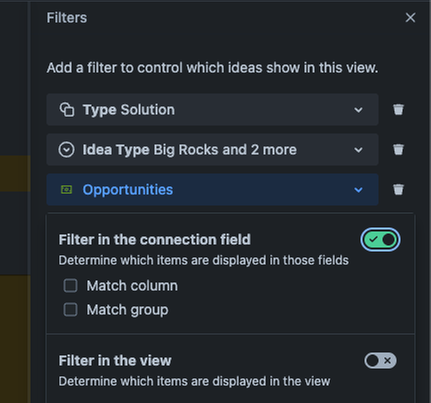

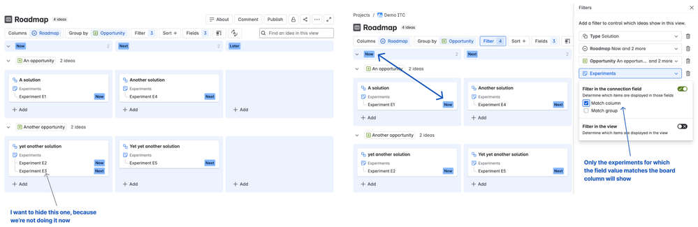

@Tanguy Crusson , the feature "filter in the connection field" is great. I think I understand how it works, but took a while to sink in. I think that it's because filter shows/hides row/cards, and this feature shows/hides values within the row/card. Did I get it right? Do other user have the same challenge or just get it?

Tanguy Crusson
May 15, 2025
@Antoni Abella Vendrell
Yes, this feature is sooooo cryptic, honestly well done understanding it šŸ˜… it's what it does.
we're currently reviewing this part of the experience šŸ™‚

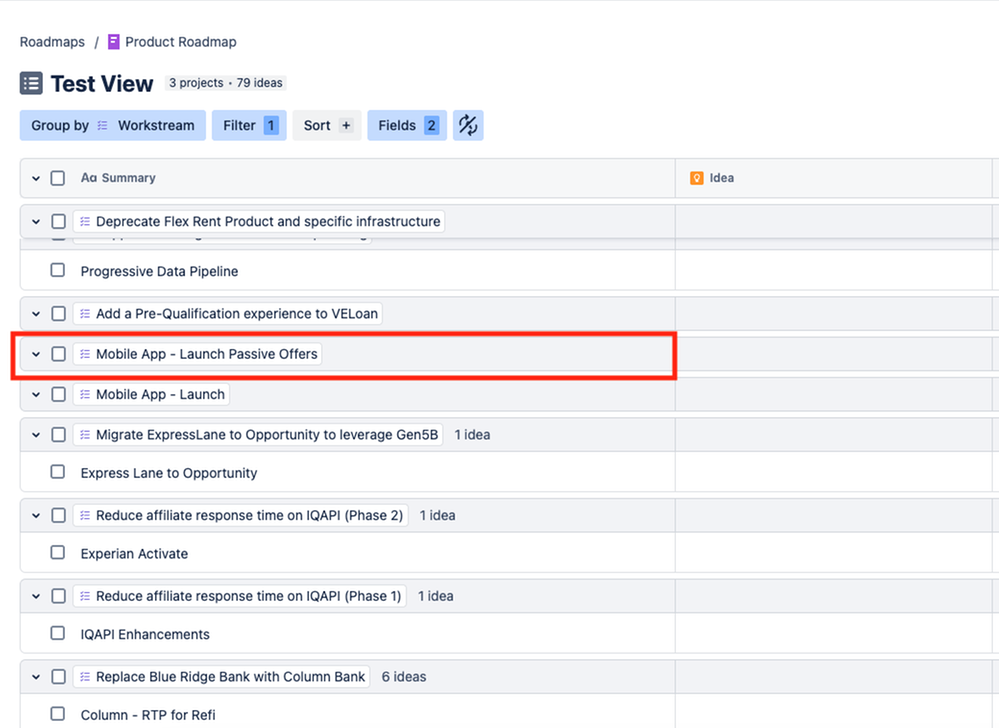

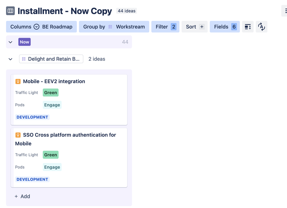

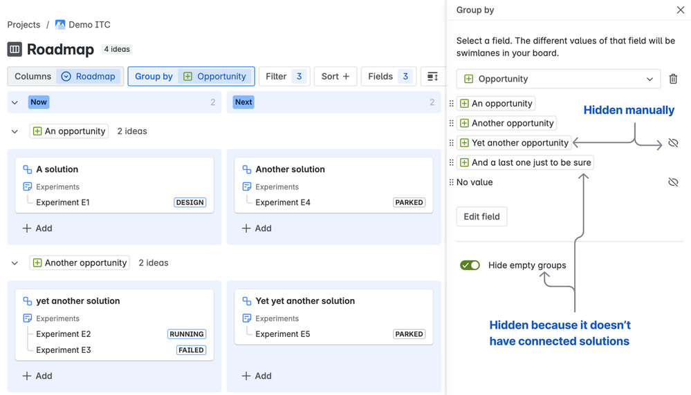

Thanks for all of your help! I'm running into another question. I want to create a list view grouped by Workstream that shows the connected Ideas underneath. This is working for some Ideas, but not others. For ex: the idea "passive offers on Mobile". It is connected to the workstream "Launch Passive Offers on mobile", but it does not appear underneath the workstream when grouped in the list view.
@Antoni Abella Vendrell copying you as well in case you have run into this!Screenshot 2025-05-16 at 11.46.58 AM.png
While I'm here, I'm also wondering why there is a grouping of "no value" for workstream, even though all workstreams have a value?

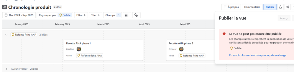

Olivier GIRAULT
May 19, 2025
Hello JPD !
Great job on the hierarchies !
Do you know when the publication of views will be possible with 'a grouping by connection' ? it's super convenient to share ideas with sub-ideas in a chronology :-)
Thank you !
Tanguy Crusson
May 19, 2025
Thanks for the feedback @Matti Desmet
@Olivier GIRAULT we're currently working on it, I don't have a date but it's coming soon.
@Stefanie Ramsay I think you should try the following:
  • Filter for "Type = ideas"
  • Group by "Workstream"
This will show you Ideas grouped by Workstream
