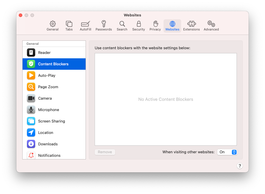

stig
January 7, 2021
You might check to see if you have any Safari content blockers that could be interfering with the login process.
I've verified successful logins on two separate Big Sur machines, one that had Jira running prior to Big Sur, and one that never had Jira installed until after Big Sur was installed.
Mo Gusbi January 8, 2021
@stig I can confirm I have no content blockers on my machine
Like stig likes this
Luka Kladaric January 12, 2021
I can confirm that Safari Content Blockers are disabled, and that atlassian.com is whitelisted, and the problem persists.
