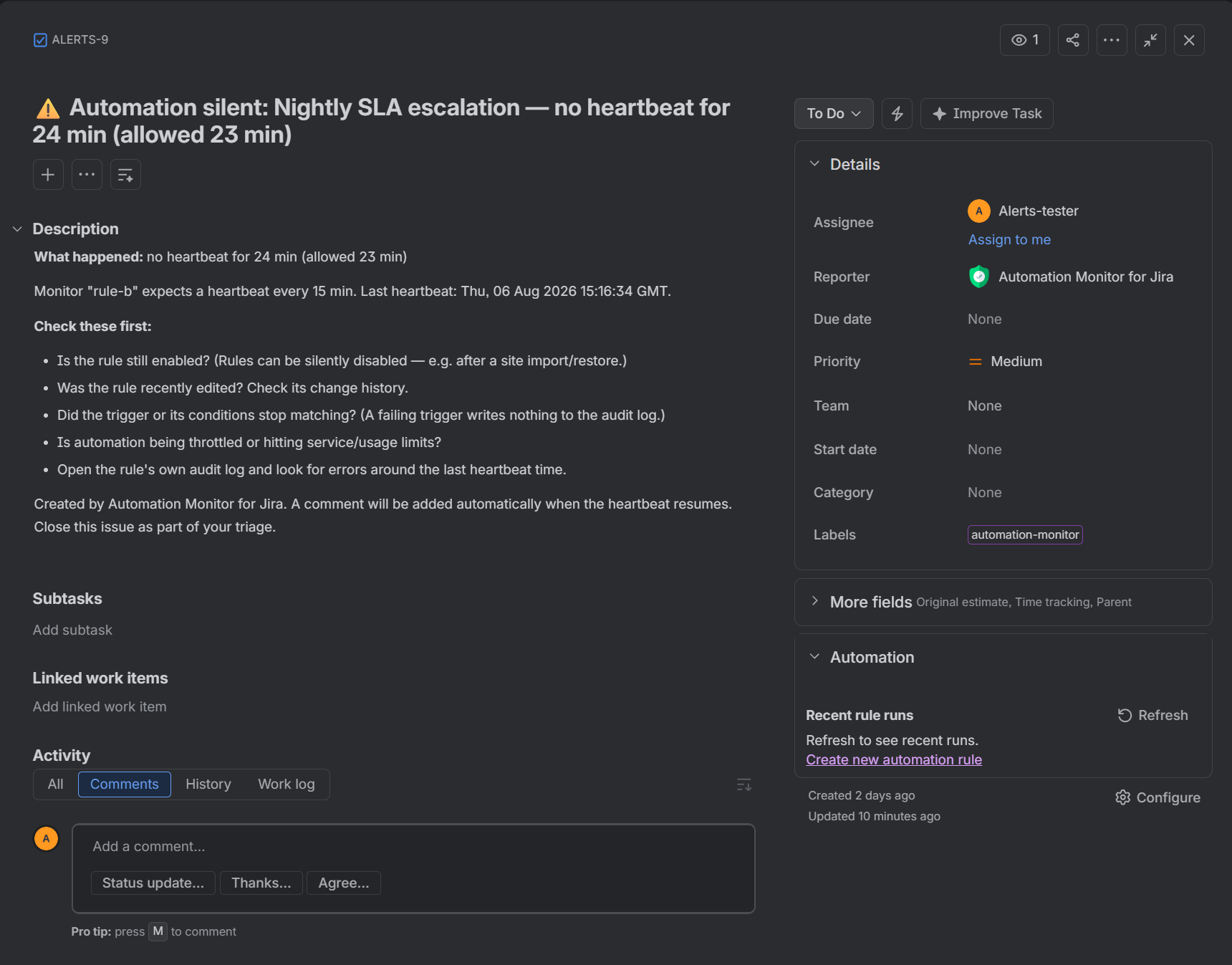

Silent failures become Jira issues you can see

Esther Ortega
August 20, 2026
Nice thread @Automation Monitor App , and I really like Mykenna's approach of using entity properties instead of creating an issue for every heartbeat: it sidesteps exactly the "you have to purge old issues" problem you mention in the original post.
It occurs to me there's a third option that mixes both ideas and I think it addresses a few of the open questions.
Instead of creating an issue per execution (which then need cleaning up) or relying on project entity properties (which aren't JQL-searchable, so the watchdog would have to read them via the API), I'd use a single control issue per rule, living in a dedicated project like "Automation Health". Each monitored rule, at the end of its flow, updates a date/time field like "Last Heartbeat" on that fixed issue, using the native Edit issue action (or, if you'd rather not spend a custom field, the native Set entity property action at the issue level).
The advantage of working at the issue level rather than the project level is that it's actually indexed in JQL, so the watchdog itself can do a Lookup issues with JQL against the control project, and in a for-each loop compare {{now.diff(issue.Last Heartbeat, "minutes")}} against a second field, "Expected Interval (min)", which you configure once per rule on that same issue. That way each rule can have its own interval without the watchdog having to match the fastest rule's cadence, which was one of the drawbacks you mentioned about the per-Space approach.
If you're on Premium or Enterprise, Automation analytics lets you see executions per rule per day, which is really handy for calibrating that "Expected Interval" with real data.
Nice side effect: since everything lives as issues in a normal project, you can build a dashboard/filter showing the health of all your rules at a glance, instead of having to go digging through invisible properties.
One more thing on top of all this: the heartbeat covers the "the rule stopped firing" case, but it doesn't replace the native email alert Jira sends when a rule gets auto-disabled after repeated errors. I find that email useful too, so I'd keep both running in parallel.
Thanks for raising this, it's a problem that's easy to overlook until it bites you — happy to compare notes if anyone tries this approach.

I have a working prototype using only native aspects of Jira and Jira Automation. Key details:
  • Each watched flow is paired with a work item in the same Jira Space.
  • A watched flow needs to only update one numeric, timestamp, or string type field in that work item. Your Jira instance should standardize on the field to be used by all watched flows.
  • A single global automation flow watches ALL watched flows. It adds comments on the watched items for missed heartbeats, resumed heartbeats, and heartbeat data errors. Simply watch those work items to be notified of heartbeat events.
I'm curious if there is interest in this prototype. If so, I'll author an article outlining it. Please reply to this comment if you're interested.

I have a new perspective on this topic. I'd really like to know your thoughts on it.
I would assert:  heartbeats generated at the start of a Jira automation flow are better. The article above instead proposes generating them as "the last action" (step) of the flow.
Why is earlier better? Firstly, it's easier. As I developed my working prototype solution, it became clear that non-trivial flows might need to be refactored for heartbeats to occur at the end of all paths through the flow. Adoption rates will be highest if adding heartbeat generation is trivial.
Secondly, no detection value is lost by generating heartbeats earlier, rather than later, in the flow. Let's explore this a bit more.
In the article under the "Four ways a rule goes quiet" section, I observe:
  • Only #1 and #2 are relevant for a heartbeat-based solution. In those cases the flow never runs at all. We really want to detect these cases.
  • #3 and #4 are logic or semantic problems with how the flow is written and configured. In these cases the flow runs, but it "doesn't quite work right". A heartbeat-based solution can't reliably cover any appreciable set of those situations.
The draft documentation for my prototype solution became overly complicated due to the "generate heartbeats at the end of all paths through the flow" requirement. Flow authors trying to implement this in their flows deserve as much simplicity as possible.
Please critique!
