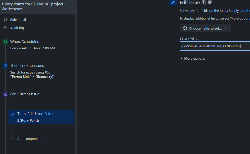

Okay so we now have a sum for the stories itself. how do we now go up to Epics and beyond? For Epics, we now can leverage the epic link field. Using the same trigger (schedule) update the JQL for the schedule and set it to look at Epics.

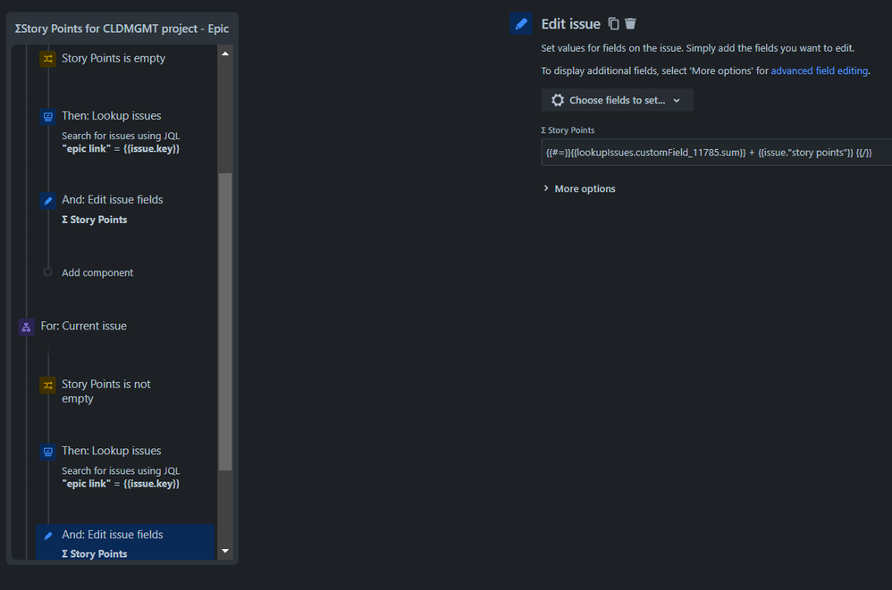

Now we need an additional step in order to make sure we look up the issues attached to the epic. But again (depending on how well trained your users are) you may need to factor in story points placed on epic issues. for this we use branches to factor in user experience and to be able to iterate of every current issue, then the lookup action using a smart variable to find where the epic link of all issues matches that of the specific key. On the edit screen we want to make sure we now look up the new custom field since this would be potentially different from the story points on the issue itself.
As you can see from the screenshot above. We use a similar structure to handle the different circumstances, look up the values and then edit the custom field with the lookedup values.
Great so we now have summed up epics. But how do you take this further up a chain if you use it? Luckily there is very little to change in these rules. For every additional level you want to use a copy of this rule. change the issue type we are aiming for (initiative, project etc.), then where it does the lookup actions, change the JQL from "epic link" to "parent link". then just a simple edit action to update the issues custom field from the lookedup values. Then you are done.
