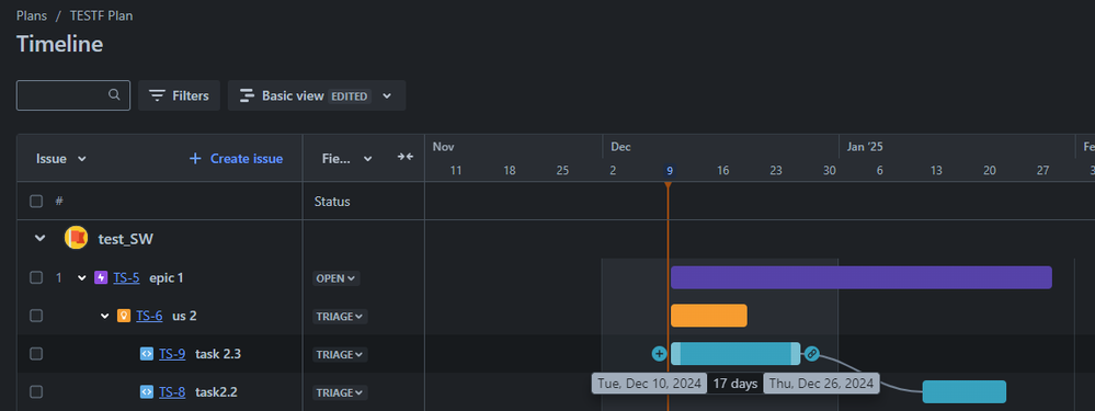

I modified task 2.3 dates in the Timeline view, so it takes 17 days to complete.

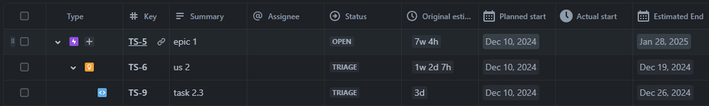

Here's what it does in the task list:image.png
As you can see, the dates are correct (they are the same), but the Original estimate is not (17 days vs 3 days).

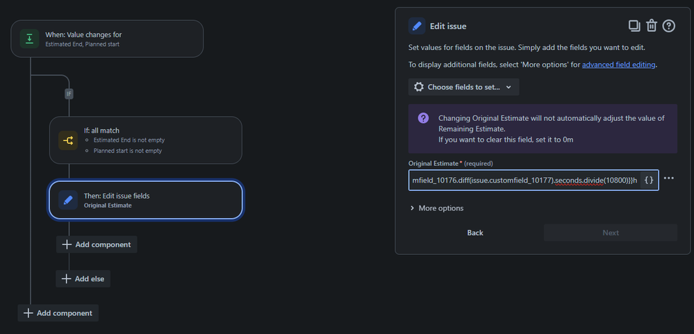

Here is a final overview of my rule:
Thank you for the help, have a great day!
