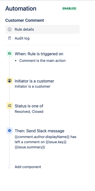

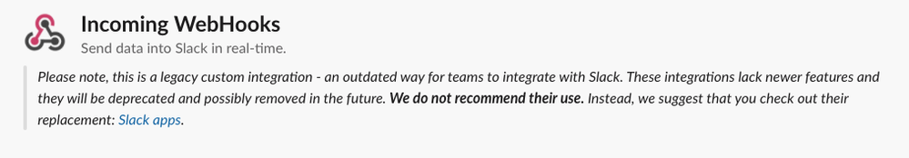

Hi Charlie - So that is where I am at. I go to my Service Desk project, go to Project Settings, select Automation and build a new rule like the one seen below. When I add the Slack option it prompts for a webhook and that page is what indicates the deprecation. Both screenshots are below for reference.

Charlie Gavey
November 11, 2021
Hi Kate,
Thanks for confirming! At this stage, webhooks are the best option for implementing  automation rules for any use cases that aren't fully supported through the Slack Connection.
