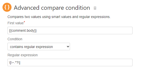

test 1 \[\~.*?\]

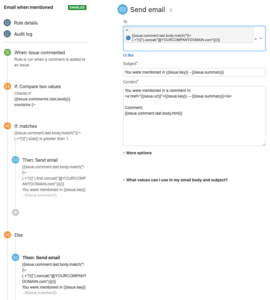

{{issue.comment.last.body.match("\[\~(.+?)\]").concat("@YOURCOMPANYDOMAIN.com"){{/}}
The rule is substantially simpler and faster, because it doesn't require an API lookup.
Unfortunately we are still unable to handle multiple mentions. In this case it's because Automation will apparently not accept a comma-delimited set of email addresses in the To: field.
Additionally, because we should handle the case of multiple mentions and at least send to the first mention (or as mentioned before, the last), we need to check for multiple recipients, and slightly adjust the regex to only grab the FIRST mention:
{{issue.comment.last.body.match("\[\~(.+?)\]").first.concat("@YOURCOMPANYDOMAIN.com"){{/}}
(NOTE: If you have the latest version of Automation for Jira (9.0.1) you could instead create a variable and use that in the Mail action. Due to a migration issue we haven't upgraded to that version yet.)
Anyways, the somewhat simpler rule (without a lookup) looks like this:

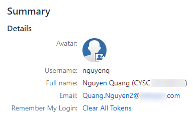

Hey Quang - is your username in Jira not also quang.nguyen2
By Username I mean what you see at https://YOURJIRAINSTANCE/secure/ViewProfile.jspa
Quang Nguyen
September 11, 2023
Hey Darryl, my username in Jira is "nguyenq"
Not everyone in my company will be using Jira. Also I think the original person with my email may have left.

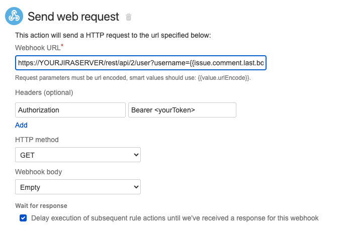

Lookup Email
OK, looking up an email address for a username. For that, you're going to have to make a call to the REST API, and you'll be calling doing that with the "Send web request" described in this article.
NOTE: In that article, they are talking about Jira CLOUD, not Data Center, so you will need to do a few things differently than it specifies:
  • Here are on-prem instructions to Set up a Personal Access Token
  • You will not need to base64 encode your username+token
  • Your Authorization header will be: Bearer <yourToken>
You should then be able to follow the instructions ahead, but instead use this URL:
https://YOURJIRASERVER/rest/api/2/user?username={{issue.comment.last.body.match("\[\~(.+?)\]").first.urlEncode|issue.comment.last.body.match("\[\~(.+?)\]").urlEncode}}
Yeah, that's ugly. Oh, and unlike the example, we can't put that into a variable because Automation for Jira Data Center doesn't support them yet. (Oh wait, they just added it! See JIRAAUTOSERVER-22. Well we had some problems with that version of Automation.)
ALSO, had to add urlEncode to the URL in case you have some non-ascii characters in your usernames.
It should look something like this:
So yeah, after you make that Web Request, it returns the response in {{webhookResponse}} and you can get the email out of that via {{webhookResponse.body.emailAddress}}.

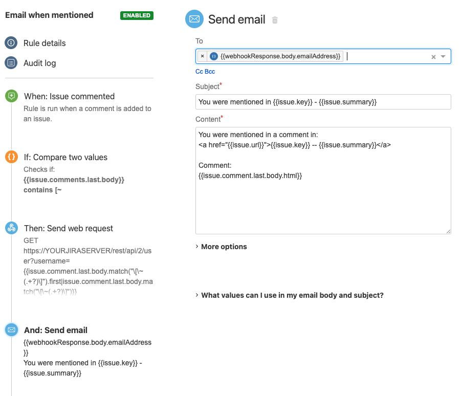

The final rule
Anyways, the end product should look something like this: (Oh yeah, I use an IF at the beginning to make sure the Comment has a mention in it at all.)
Whew. That's kind of ugly. But there you have it!

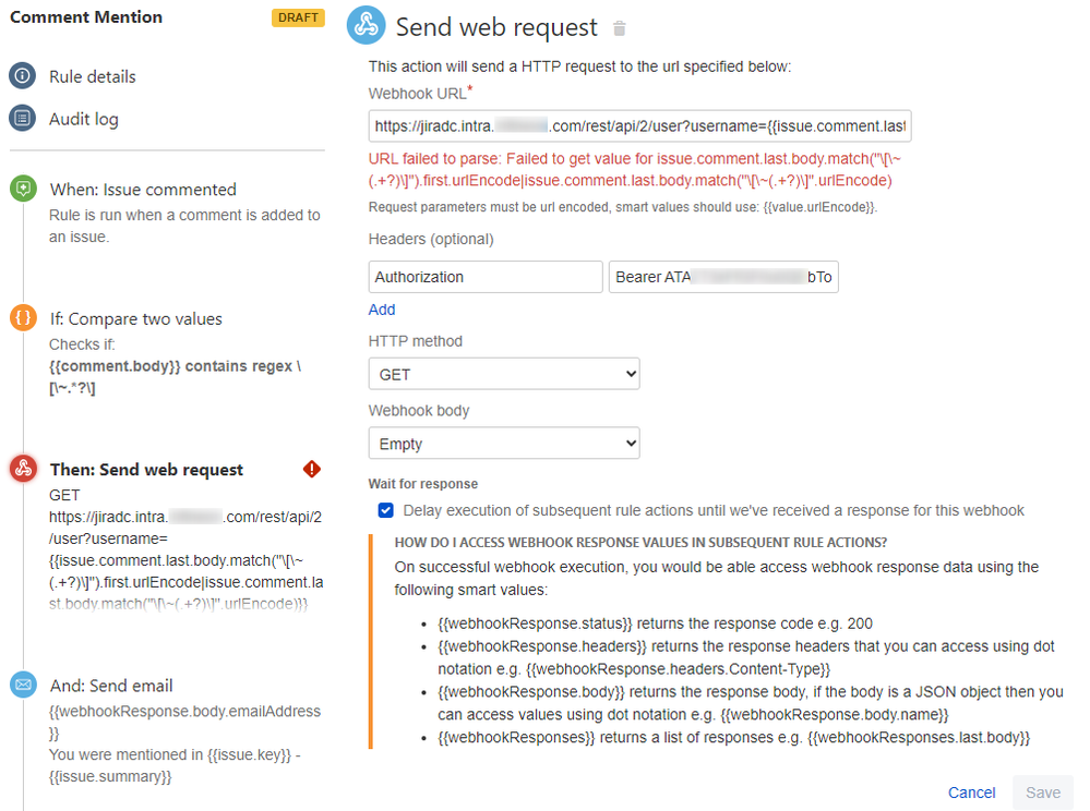

Hi, I did try this but I am getting an error:
I did notice in the Send Web Request article you linked, the HTTP method used was POST, whereas your steps used GET. I did try both and got that error each time. I did not encode anything.
Appreciate all the help!

GAH, I had a typo in the URL (last parentheses was in the wrong place). I've fixed it above, and here it is, corrected:
 Sorry about that. I added urlEncode late in the process.

The rule is now publishing successfully. However the notification email is not being sent and I am getting this error in the rule's audit log:
Error publishing webhook. Response HTTP status:
401
Error response HTTP body:
<?xml version="1.0" encoding="UTF-8" standalone="yes"?><status><status-code>401</status-code><message>Client must be authenticated to access this resource.</message></status>
I've tried clearing my cache and cookies, and this still happens. I am an admin on the board I am testing this on.

Hey yeah, no, that's definitely a problem with the Authentication token.
You followed these steps:
  • Set up a Personal Access Token
  • Reminder, you DO NOT need to base64 encode your username:token. That is only on Cloud.
I would delete the old token, regenerate a new one, and very carefully copy/paste it into the Headers (and don't close that window with the token until you've confirmed it works):
Authorization: Bearer JUSTYOURTOKEN
(You do not enter a colon on the site. And you need to make sure there's not any extra spaces before/after.)

Oops, I was trying to create a token through https://id.atlassian.com/manage-profile/security/api-tokens before, which has a much longer token.
I did go through your Personal Access Token link, and generated a PAT which is a much smaller string. My token is about 45 characters.
It is still failing with the same error code, 401, when I tried it with the other token though. I've tried copying it manually, copying it using the clipboard button when creating a token, and manually checking all the spaces before and after.

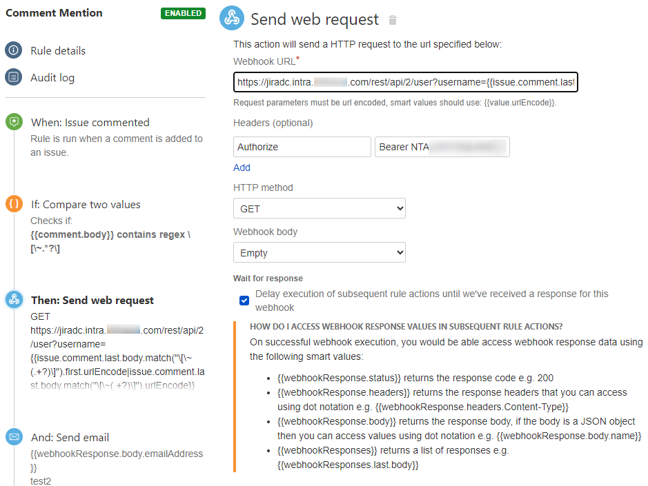

Here is my setup, not much has changed:
And here is the audit log:
Thanks for hanging through this with me!
Darryl Lee
September 11, 2023
I think see the problem now. For the Header name you wrote:
Authorize
It should be:
Authorization
Give that a try!
Quang Nguyen
September 12, 2023
That worked! What a simple mistake on my end. Thank you so much for helping me through all of this.

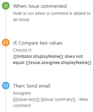

This rule is for general comments, to notify the assignee when a comment is made on a task.
When a user is @ mentioned, it is firing both this general comment rule and the @mention rule we set up above. I would like to make it so that only one of these fires (ideally only the @mention rule). How would I make sure only one rule fires?

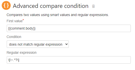

I have tried adding the condition that was originally used to detect that a comment was made, but this did not work:
I've also tried "contains regular expression" for a few negative lookaheads I found. The thought was the negative lookahead would fail when it detects a comment, so the condition would return False and not trigger the email. That also did not work, but I suspect that's primarily because I did not set the regex up correctly.

Darryl Lee
September 18, 2023
So let me see if I'm understanding:
  • You want a rule that notifies the Assignee of new comments IF
    • the commentor is NOT the assignee
    • AND the comment does NOT contain a mention?

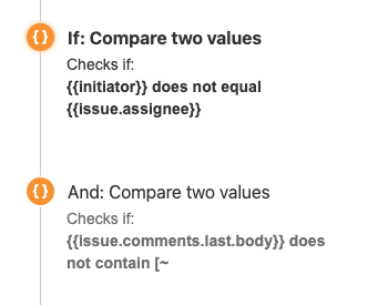

So it would seem like you need to have multiple conditions. I tested this and it seemed to work. Also, I removed some things that I thought were not necessary (also it's safer to try to match initiator and assignee based on usernames instead of displayNames, since as we know, there can be multiple people with the same name).

Thanks so much! Currently, when the assignee is @ mentioned in an issue, they would be sent an email that an issue they were assigned to was mentioned on, and that they were @ mentioned. I wanted to create rules that:
  • Sends them the email that they were @ mentioned
  • Did not send them the email saying the issue they were assigned to was commented on, since this was redundant.
I managed to do that by adding
{{issue.comments.last.body}} does not contain {{issue.assignee}}
and testing using the audit log trick you showed me. I did not know log messages could be added that way. This is going to help me troubleshoot things much easier in the future, thank you!
