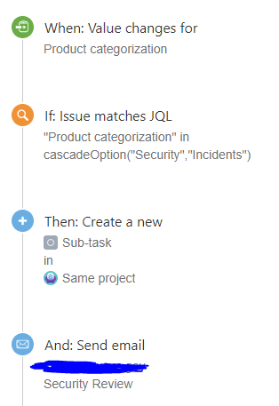

Pretty much what the title says. I have automation set up so that when a field value changes, a sub task for the issue in which the field was changed is created, and an email sent.
Both things happen as advertised, however the Parent issue for which the sub-task was created gets its Resolution put into Done. The Status is still In Progress, just the Resolution changes.
I don't see how to prevent this. Anyone else seen this? Have any ideas how to avoid it?

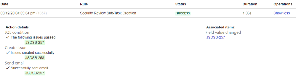

I looked at the ScriptRunner Listener (I only have one set up) it just looks for SSNs, this test issue I made doesn't have anything resembling a 9 digit number. Here's the log from the plugin:
So ticket 257 is the parent.. 258 is the sub task that was created, and shows up on the parent ticket. But 257's resolution gets marked as Done when it shouldn't. Again it doesn't even move through the workflow at this point. All I'm doing to activate this automation is change a field value.
