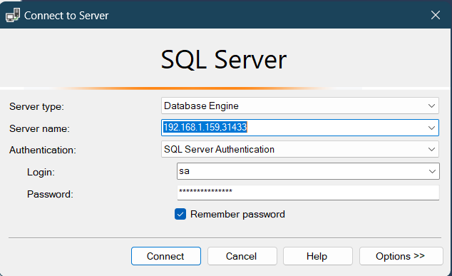

start the application and click on connect then configure as following:
     Server name: node IP,31433

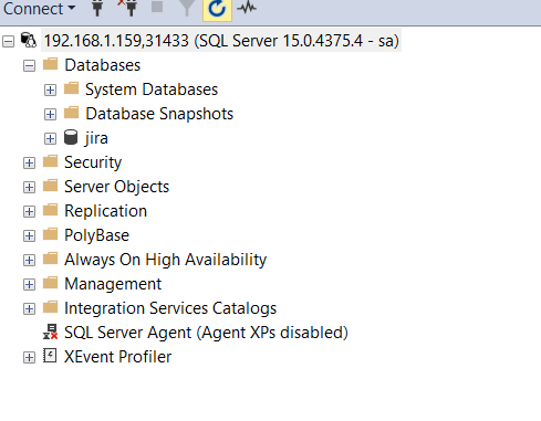

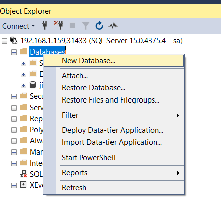

after connecting the database click on database folder and select New Database:
and create new database with the name Jira and the owner is SA
Now the database is ready to go

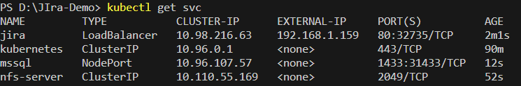

check that the service is created and running
kubectl get svc

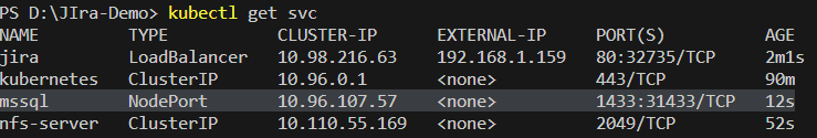

NFS-Server IP
before we start we need to know the nfs-server ip:
kubectl get svc

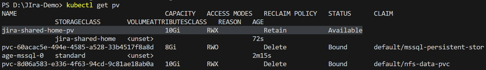

check that the PV created:
kubectl get pv

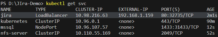

after creating every thing you need to make sure that Database is running and having database named Jira with the credentials you added and the NFS-Server is running along with PV and PVC, Make sure that the Jira Port is Exposed correct
Update the Database configuration in the file with the database ip
kubectl get svc
