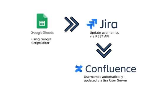

On this middle server we imported the full site backup that was generated from cloud (both for Jira and for Confluence). We used the developer license for Jira and Confluence. On the middle server, we created a Jira User server and linked it to the Confluence instance. This allowed us to re-use the exact same user base as existed on Cloud. The Jira User server was put to the top of the list in the Confluence user directories, so Confluence would use the usernames from Jira's directory rather than its own internal directory. Remember that both Jira and Confluence's internal directory hold the same users and usernames as they are included in the cloud export. Linking them together allows you to change usernames in Jira and automatically apply that to Confluence.
This should ring a bell and remind you of the mismatching username problem. We created a script that ran over a spreadsheet of usernames and email addresses and applied changes through the Jira API. Via the API, each email address was put in a search query and returned the available user on the middle server (which came from cloud) and then updated this cloud-imported username to the username defined in the spreadsheet (which were the usernames used in the active directory).
Because of this change, all data in Jira was mapped correctly to the new username. And as the cherry on top, because of the Jira user server setup, all Confluence data was also automatically updated to the new username.

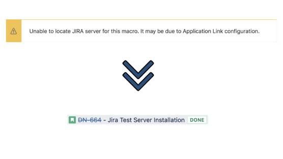

On top of this, we had a safe way to use database queries to fix Jira macro's that pointed to the wrong application links (they still pointed to cloud).

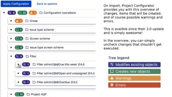

Now it was time to export all projects (data and configurations) and upload these configurations to production (which should have no impact on existing configurations as we updated everything on the middle server). You'll get an overview by Project configurator of the changes that are being applied to existing configuration, go through these carefully to see if you missed something.
In the first batch, we choose not to import boards, filters and dashboards as they need extra attention. For example, usernames that had been changed, would break filters. Same goes for renamed projects or project keys. We fixed these by extracting the config.xml file out of the full export zip and updating all references that were used in the <queries> tags with the find & replace tool which is available in most text editors.
Import the updated XML file and you're done... with Jira.
