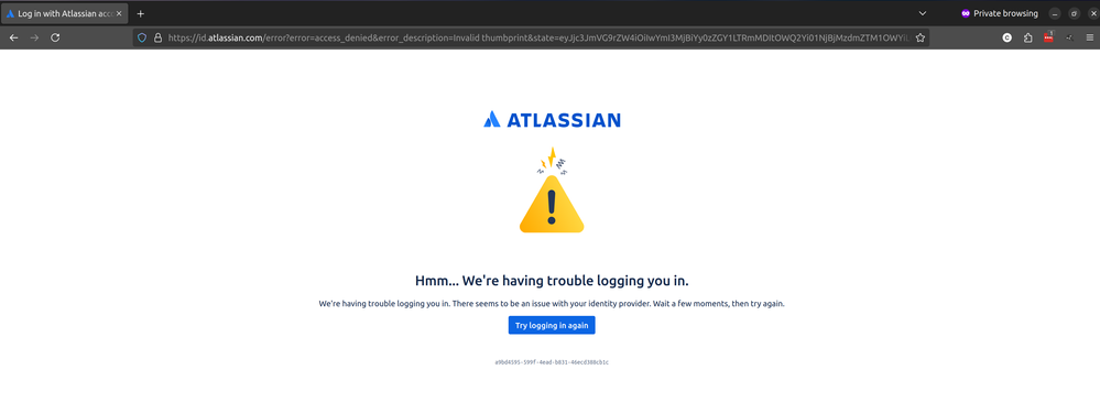

I have added SAML SSO and activated an auth policy to enable and use SSO. I use keycloak and when I try to log in it redirects me to keycloak and I log in and it redirects me back. But then I get the following error:Screenshot from 2024-06-26 15-49-38.png

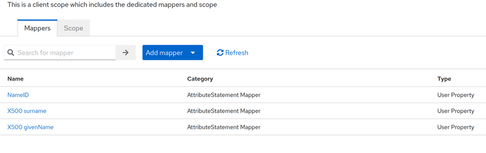

Ill also share my mappers in keycloak in case my mistake is there.Screenshot from 2024-06-26 15-59-41.png Thanks in advance!

Can you please attach a screenshot of the error with the browser URL included?
If you can do that for us I will be able to help or identify the problem.

That error tells us that the certificate is expired, to renew it please follow the next steps:
  • 1. Go to admin.atlassian.com<http://admin.atlassian.com/> and select your organization.
  • 2. Go to Identity Providers and open your SAML configuration
  • 3. Go to your IdP Dashboard and download a new x64 certificate.
  • 4. Go to your SAML Configuration and update the x509 certificate field with the new certificate.

Charlie Cramm
June 26, 2024
Hey @Hector Menchaca
Yes thank you it works now.
And I'll thank you once more for your speedy responses.
