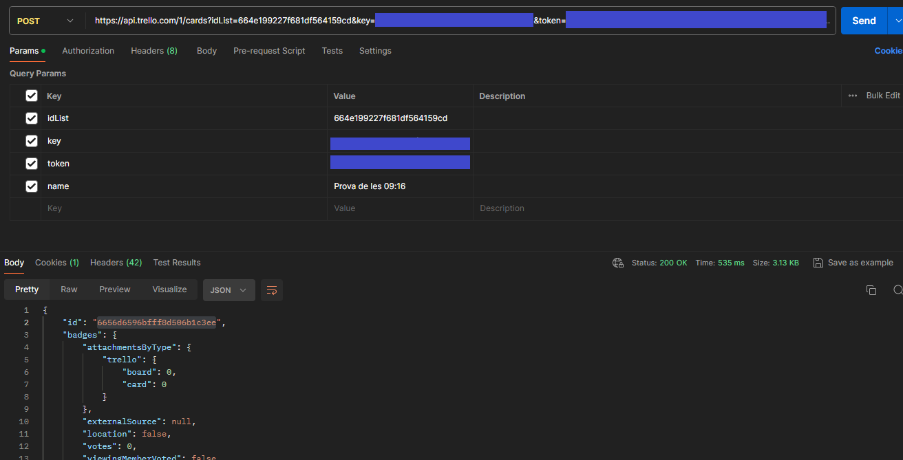

I'm developing a integration between TRELLO and our RDP via REST API.
Accordig to your documentation, I use a POST message to create a card in a specific List in our board.

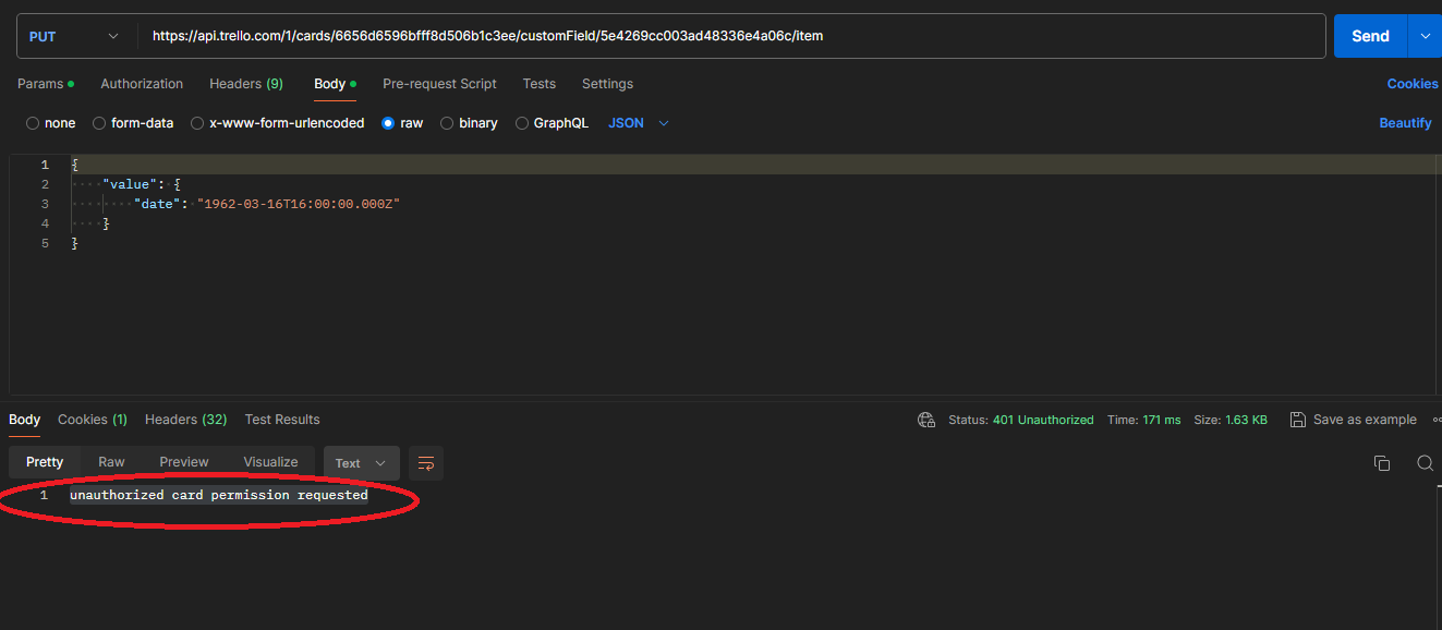

Then I need to update a value in one of ours custom fields, for the same card. Then i send a PUT message indicating the card, the custom field and the value, but I get the result "unauthorized card permission requested"
The Api id and the token are same in both messages. And i think I have full permissions.
Testing I use Postman. Please see attached screenshots

1) you might want to blur out the key and token in these screenshots
2) i tried this and it worked for me - i would make sure you have the right custom field id, because it was a little confusing for me at first to figure out what that was:
If that doesn't work, you might wanna create a support ticket here and see if it's still throwing that error: https://trello.com/contact

For the point 2) I don't know exactly from where you got your image. I need to clarify my initial approach:
Brittany:
While I was clarifying my approach, I found the problem: In the PUT message sent there was neither the ApiKey nor the Token, although it was in the 'Params' tab of Postman.
Thank you su much and sorry for the nonsense.
