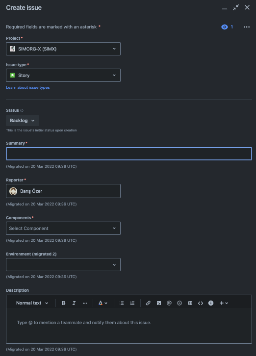

Hello,
When I create a task in a project, I want a special template to be created for the description text input field when the task type is "Story".
I can explain the steps as follows; Let Create > issueType (Story) > description be the articles I want.
After clicking Create, I want the texts I want to be written in the "Description" field below.
I researched the add-on. But I want a free solution.
Is it possible?
Thanks.
