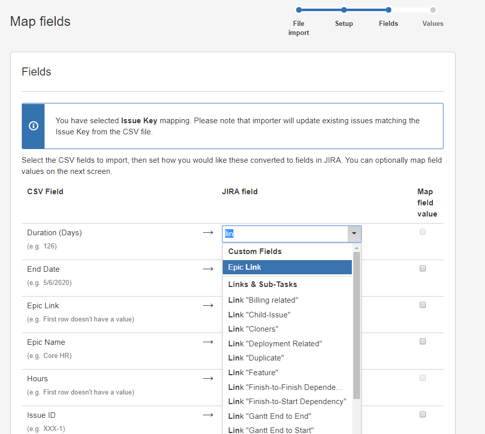

Hello,
I would like to upload via a CSV file a task (Type = Story) that includes an Issue Links of "has to be done after" and "has to be started together with" but in the process of uploading the CSV file, in the "Map fields" section, I don't know what select for these options:

Hi,
I understand that you want to be able to import a CSV file into Jira that contains link issue data.  I would recommend reading our KB In Import issue links from a CSV File in Jira server.
In order for this to work, you need to setup your CSV file to have columns that will relate to the directional link type (examples such as causes and "is caused by" as different directional link type of the same link).  Within those columns, you need to either use the Jira issue key (ABC-432) or the Issue ID value to refer to which issue this is being linked to.
Once your CSV file is setup that way, you can then map the directional link type column name to that corresponding "Link 'has to be done after'" and then the importer in Jira will be able to create the correct link type to the correct issue.
Try that and let me know if you run into problems getting this to work as expected.

Deleted user February 24, 2020
Thank you @Andy Heinzer . it worked!

Wouter Bruinings
January 18, 2022
Hi @Andy Heinzer
We have been trying to link inward links of a type, but it seems like CSV import will always pick the outward direction.
When we execute the import, the wizard let's us select different link types, but there is no way to set the direction.
Could you confirm it's only possible to use the outward link type?

Don McCarty
December 6, 2023
I realize this is old but I'm also having the same problem.
I'm able to import into a "has to be done before" link.
However, I do not have the option to specify Inward to also create "has to be done after".
I've named my columns exactly as they are named in the exports as "Inward issue link (Gantt End to Start)" and "Outward issue link (Gantt End to Start)".
This has no impact as the mapping is only to "Link 'Gantt End to Start'".
How do we create a 'has to be done before' link durin an import?
