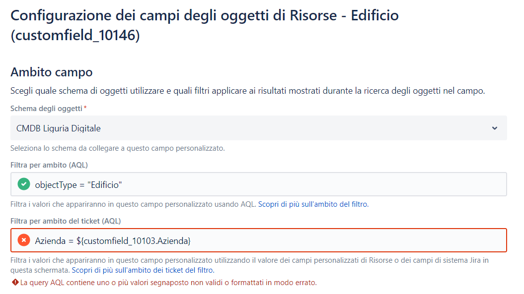

for customer portal configuration I'm creating 2 different asset type (Contatti and Edificio), the first asset reppresent people and the second one the building.
For the Contatti custom field I have no problem and I created it with the custom field 10103; Problems spawn when I try to filter Edificio (custom field 10146) with the attribute Azienda of Contatti object.
What I want to do is filter buildings based on people's company using the dot notation but I have some problems:
Azienda (Company) is a field in both classes but for some strange reason the dot notation in the filter is wrong.
The question is: there is any OQL validator to test my query and understand where I'm wrong?
Thanks,
Giuseppe.
Solved!
I put another field in the middle with all company and I filtered this field using the inboundreferences function.
After this I put company visibility to hide.
