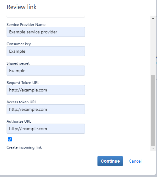

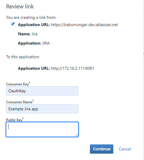

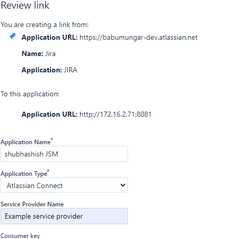

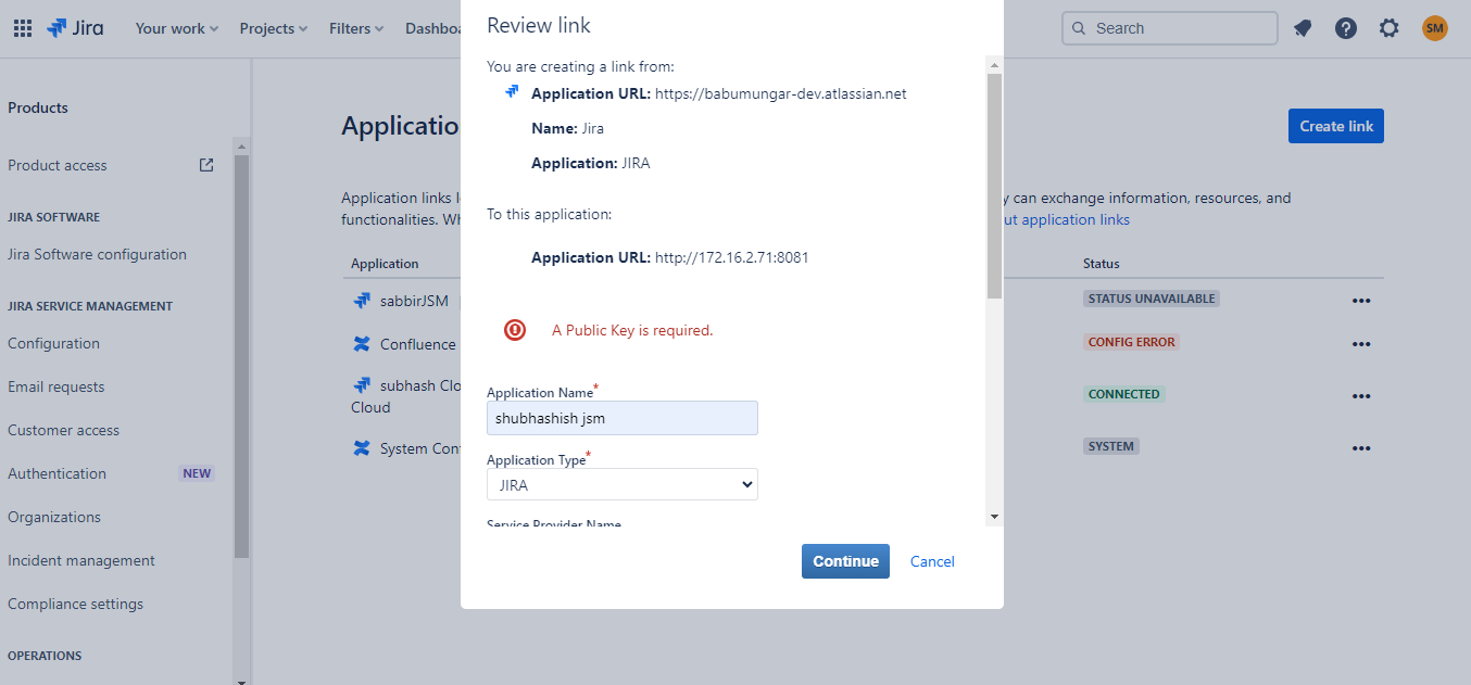

while trying to make connection between cloud and datacenter its asking to fill so many input fields that are mentioned below
service provider name
consumerkey
shared secret key
request token url
access token url
authorize url

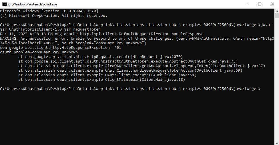

to solve this i followed this site https://developer.atlassian.com/server/jira/platform/oauth/ .
i successfully completed upto step 2 , but in step 3 iam getting error like consumer_key_unknown (pls find the attached img consumerkeyError.png) . And also i attached imgs which are having all the input fields that are being asked while making connection from cloud  to datacenter pls refer them and help me to get the solution consumerkeyError.pngMicrosoftTeams-image (1).pngMicrosoftTeams-image (2).pngMicrosoftTeams-image (3).pngMicrosoftTeams-image.png
