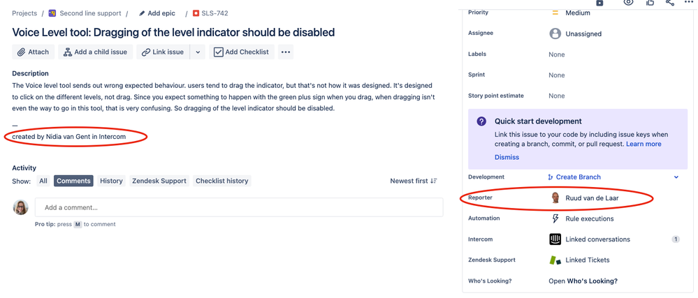

I've added a picture, because I'm still confused about the fact that in Jira it clearly states that I'm the one who created this bug in Intercom (which I did), but the reporter is my colleague, who has nothing to do with Intercom. You're telling me that that's the way it was designed, and that it's not a bug within your software? Just checking, because it seems strange to me. But if this is the case then I will create a different "intercom app" user for us.
Hey Nidia,
Yes, that's right, generally speaking, that is correct because that is how your Intercom app is currently set up.
Note that Intercom and Jira are two independent software vendors. There is no clear 1-1 matching of Jira users to Intercom teammates or vice-versa. Some customers may have a corresponding Jira user account for each of their Intercom teammates but that is generally not the case and the app has to assume that not each user in one system has a corresponding user in the other system. The FAQ here explains this in different words.
In your case, the Intercom app was most likely installed by Ruud van de Laar. At the time of installation, the app asked him to authorize a connection to your Jira Cloud instance. Because Ruud was logged in to Jira with his personal (Jira!) account he became the app user for the Intercom app. As a result, every new issue will be reported by him. Note that Jira issues have to be created/reported by a Jira user. The Atlassian APIs do not allow us to use Intercom user accounts to create Jira issues.
You can confirm that Ruud is currently the app user, by going to Intercom and clicking on App info on the app home screen. Ruud will show up as the app user under the Jira connection.
Regarding the "created by ... in Intercom" comment. This comment is generated by the Intercom app and is referring to the Intercom teammate that created the issue. Note that it is not referring to a Jira user but the name of the Intercom teammate that created the issue.
To avoid confusion, I would suggest setting up the Intercom app using a generic Jira user. To do this I would first create a new generic Jira user, e.g. called "Intercom app". After this, follow the instructions on how to configure the app with a different Jira user. This time, make sure you are logged in to Jira with the "Intercom app" user. Once the app is reconfigured with the "Intercom app" user, the app info screen in Intercom will show "Intercom app" as the app user, instead of Ruud. Next time you create a new issue, the issue reporter will be "Intercom app" instead of Ruud but the reference to the Intercom user in the issue description remains the same.
