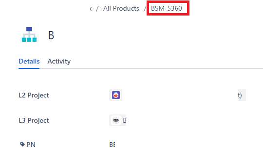

By creating a custom field using Assets, it is possible to obtain the values (text) of the field through the Key (custom number) of the object. In other words, the mission in the automation is to locate the Key (example: BSM-1234) of the object through the JSON that ProForma provided. It is worth noting that it will only be possible to locate the Assets object ID if you link a custom field in the form in the format "Assets" (or insights).

USING ASSETS
In my case, our Support team has severity matrices based on the product, and therefore, each type of issue has a different severity for priorities such as High, Blocker, Medium, and Low.
Based on this, I structured a schema to have:
  • My product > Business Flow and Type Of Issue by product and related each type to its severity

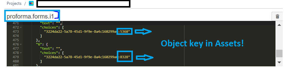

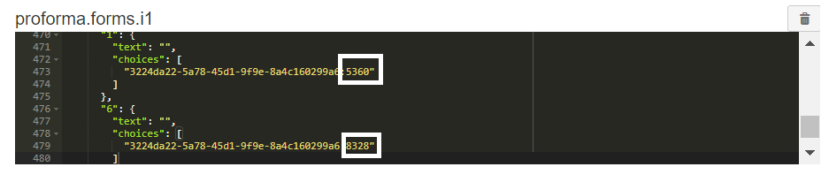

Finding the object number in JSON ProForma:
Look in the “Entite Properties” (JSON) of the ticket for the value after the “:”
Note that only the numbers after the ":" (colon) change and the initial structure remains!

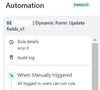

  • Trigger: in the example, I set it to be manual for testing purposes.  trigger-jira.PNG

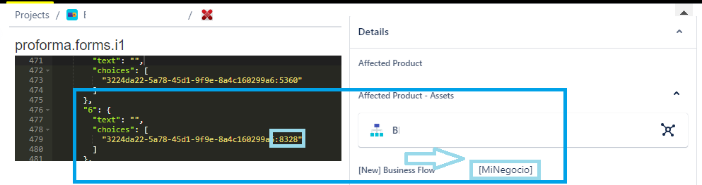

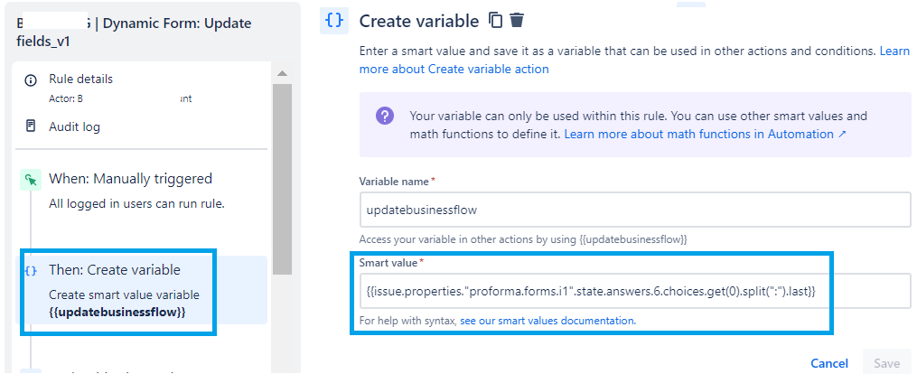

  • Create variable: at this stage, I will insert a variable in the automation so that it can search in the "Entite properties" (JSON) of the ticket for the value after the ":". For this, I used the split in the automation (as shown in the print).
    JSON - ticket:
    Variable in automation:
    {{issue.properties."proforma.forms.i1".state.answers.6.choices.get(0).split(":").last}}

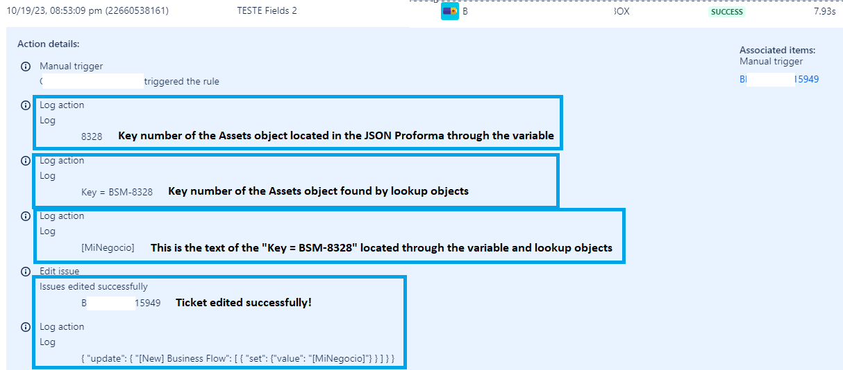

  • Logs: to track the values that the automation was finding, I added two logs: 1. for the ID number and the other to search for the complete ID with letters (the latter must be identical to the object ID in Assets. For example: BSM-1234)

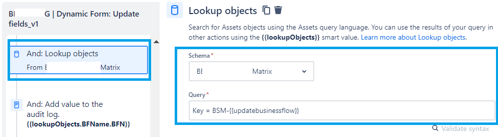

  • Now, I added the "Lookup Objects" action: I selected the schema where my objects are structured and in the query I placed the search as follows: "Key = BSM-{{updatebusinessflow}}", where "Key" is the key of my object (object in this case will be the option chosen in the portal. Example of the object text: I need to reset my password) and "{{updatebusinessflow}}" is the variable that I already searched:
  • Editing a specific field: Now that I have found the text using the variable to access the ProForma JSON and the lookup Objects to locate the text related to the Key, the last condition is to insert the found value in a common field (text type) in the Jira ticket. For this, I used "Edit fields", selected the field "[New] Business Flow" and inserted the smart value {{lookupObjects.BFName.BFN}}. In other words, I asked the automation to insert in the specific field the value that I located through the search in the object from the Key:
