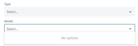

As an example: I have no Type Selected so my Model drop down shows No Options

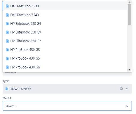

When I select Type as HDW-Laptop, now you can see my Model drop down is Filtered to All Models with a Type as a Laptop (sorry my screenshot is weird. The drop down actually drops up, not down)
This is the Asset View showing all models with type HDW-Laptop:
