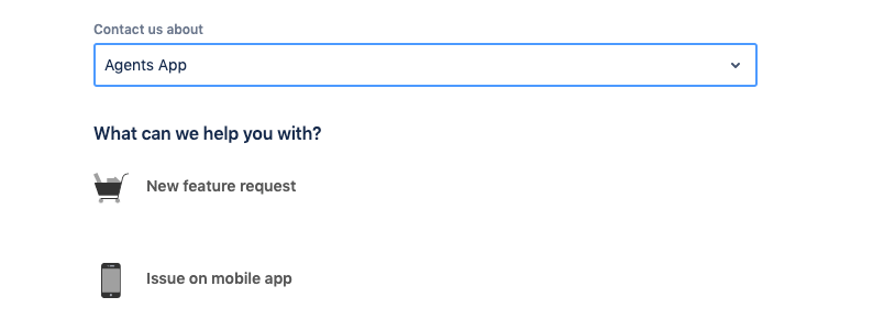

It would be useful to know where the customer sent the request from because I have set up the portal groups by identifying the various modules of the platform, eg. "Backoffice" "App Guest", "App Administrator"
thanks in advance for your help
There is no way to easily determine Portal group that an issue was raised from. However if you aren’t duplicating request types across groups then you can determine based on the request type which group it came from.
Hi, the problem is I want to use the same type request on multiple portal groups, for example:
Understood. Unfortunately you won’t be able to determine which group issue was raised from in that case. There may be some add on that provides a means of doing this but I am unfamiliar with them.
Thanks for the answer @Jack Brickey
However, I don't understand the logic behind it. Why there's a "grouping" or "filtering" feature while it actually doesn't exist? What are the use cases of "Portal Groups" then?
