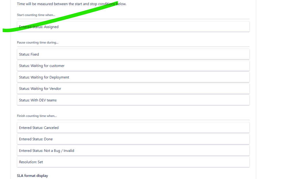

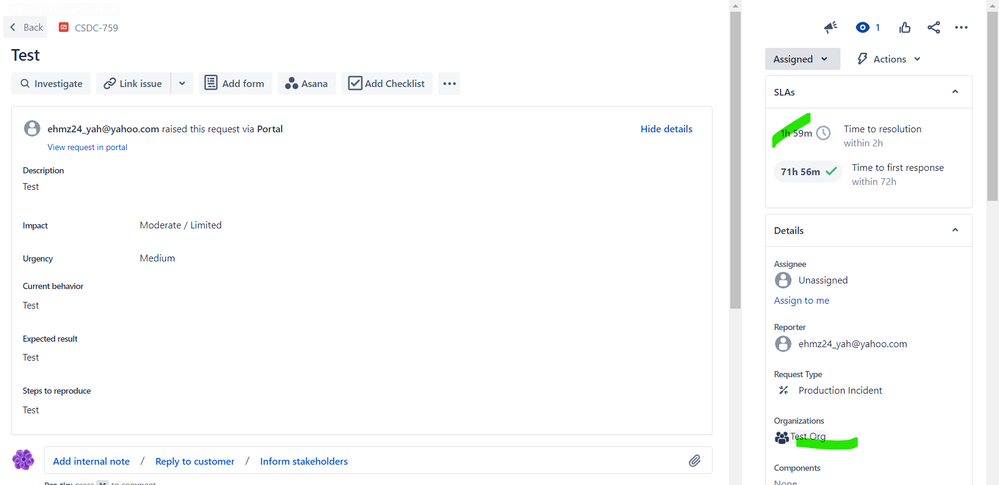

Help! - Our SLA resolution suddenly missing in one ticket
Seems our SLA Resolution Conditions are working fine perfectly before however, for this specific ticket, it is not showing:

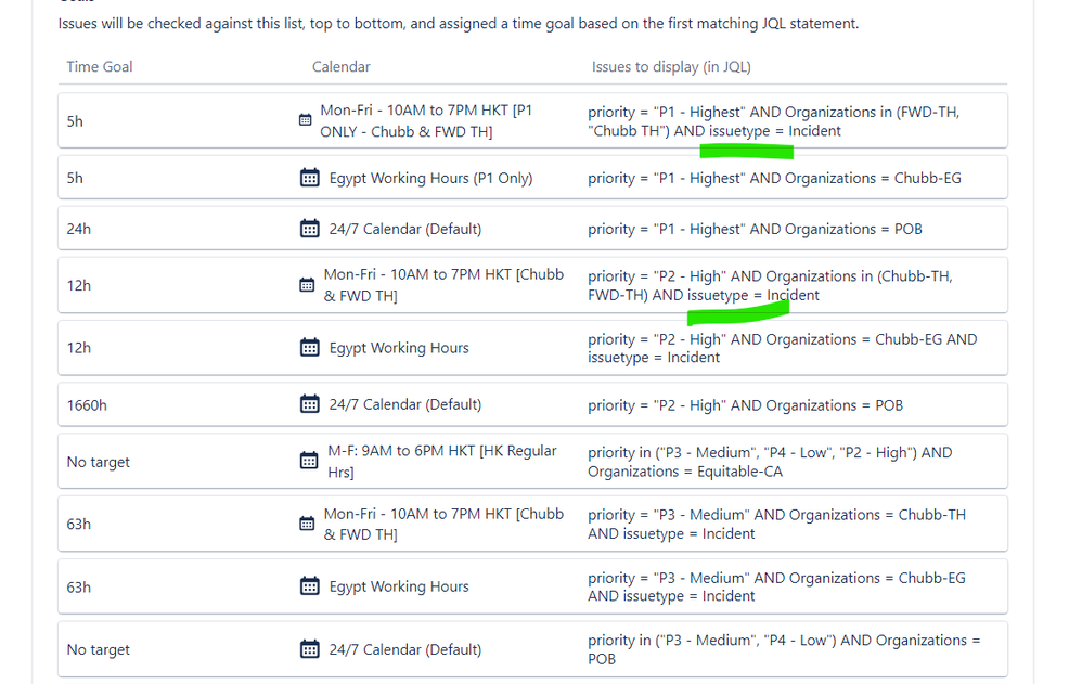

Hi @Emery Manayan
Your goals get typo see "redline box"
Hello, actually on our end either type or issue type is good and being accepted. But I also tried changing it earlier into issuetype but still our SLA Resolution did not appear Type.png

Hello Daniel, there is no changes on our end and I have tested a ticket and SLA works fine.
The second question about, DONE Status was correct, resolution was set to done. However, regardless if the ticket was still open or closed, for that specific ticket above, it did not show.

The issue is type Incident, but does it have the correct priority and any of the 2 organisations set on the issue as specified in the SLA?
Yes, it's under one of the org set and also , I changed the type into issuetype and same thing (actually on our end, it is being accepted either type or issuetype

All seems to be just fine.
The JQL usage of the keywords type or issuetype should not be the cas, as they can both be used.
