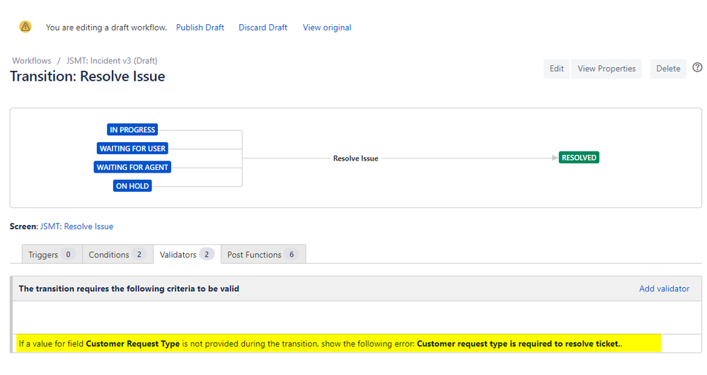

I have the exact same use case. Here's my validator:
On my test ticket, you can see here the request type is blank (after switching the issue type):
And yet, I still have the ability to execute the transition:
If anyone out there has a solution or work around let me know!
