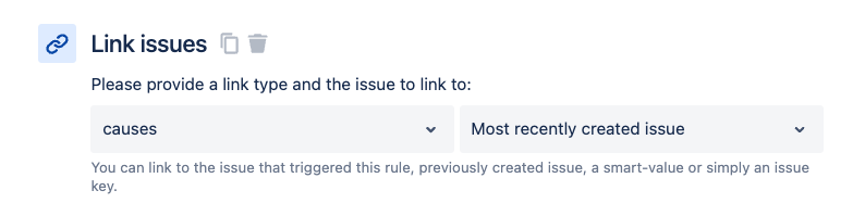

@Trudy P Claspill - So i discovered that I had probably only created an automation that made a copy issue in the sw project and not a linked issue. The first picture shows what I previously had done and now I have made som changes and added the And Link issue to. and I used the Link type "Causes" (like the third picture shows)
So now I will get back your instructions above and see if I can get it to work. :)

From your previous comment image you changed your rule creating the copy issue so that:
In your new rule where you are trying to copy comments the rule reads as:
In your For Linked Issues step the Type should be caused by.
