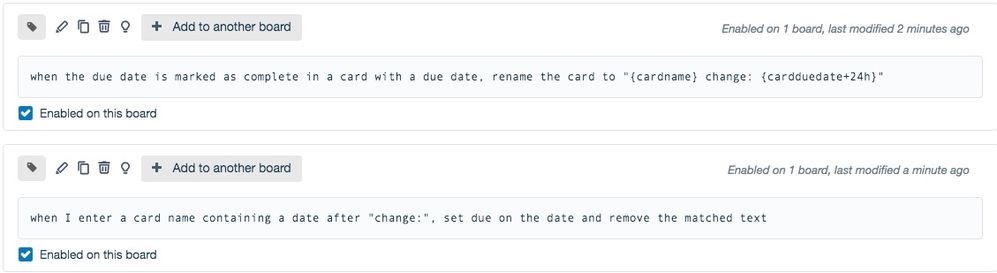

Would this work ?
CrimsonDrakon
January 19, 2022
First part works, second part doesn't.
But in any case, if I'm reading this correctly, wouldn't this instantly change the due date when the card is marked complete? Which isn't want I intended.
I'm trying to get the card so that say the due date is 11:59PM, and I mark the card complete some time before then. I want that when the due date comes, the card is put back at incomplete and the due date set for the next day 11:59PM. This doesn't seem like it would do that, unless I'm misunderstanding something.

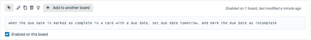

I thought you want to keep the date and time. If it is 23:59 just use “tomorrow” and you do not need to trigger the due date change by modifying the card name.Screen Shot 2022-01-19 at 8.13.11 PM.jpg

Okay I will try this and see

I understand your initial problem which is there is no trigger for when it is marked complete - but you end objective is to set the due date forward to the next day when work is completed you really do not need to wait for the card due date.
I tested the above it does switch the card to incomplete.
A completed card with a due date does not trigger and it realistic.
All the best...

Okay, this is a step closer to what I want, thank you for help.
Is there a way to keep the card as complete until a certain time? Like, say for the rest of the day until midnight, and then changing to incomplete on the next day?
milynnus
January 19, 2022
@CrimsonDrakon
Unfortunately, Trello calendar does not allow you to collect all cards with "completed" status and then set them to incomplete. You will have to use Calendar to run something at 23:56 that sets off a trigger to collect the cards and set them to incomplete.
