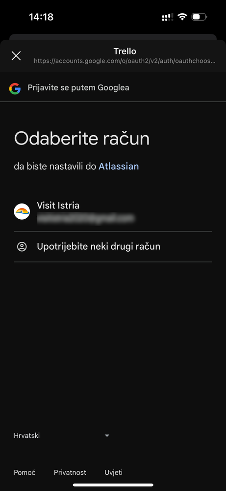

I have made some screenshots so you can better understand the problem but the video is the best proof.
STEPS:
1. login in my Teams app

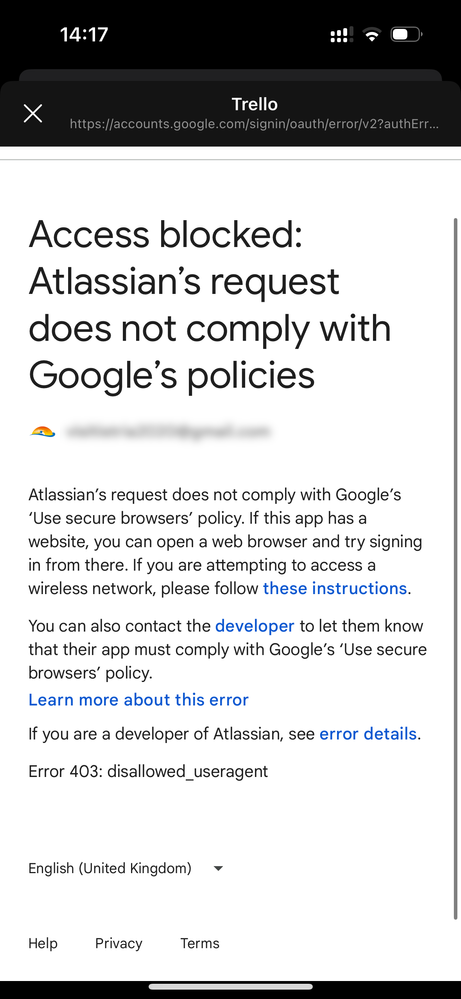

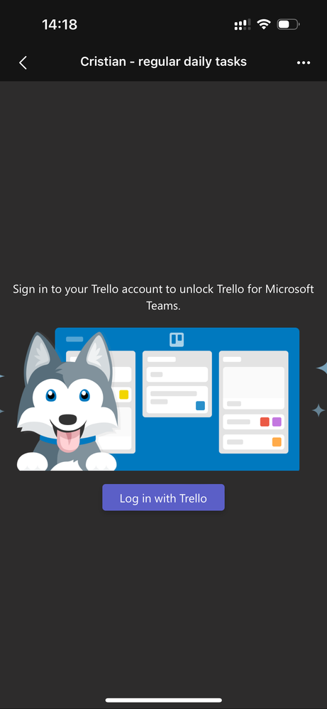

2. trying to open a table with tasks through Teams (i want to say when i open your app "Trello" its working but through the app "Teams" its not working).

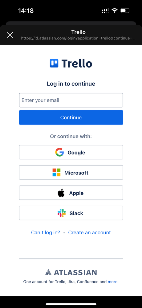

3. asking me to login
4. continue with Google
5. choosing my account

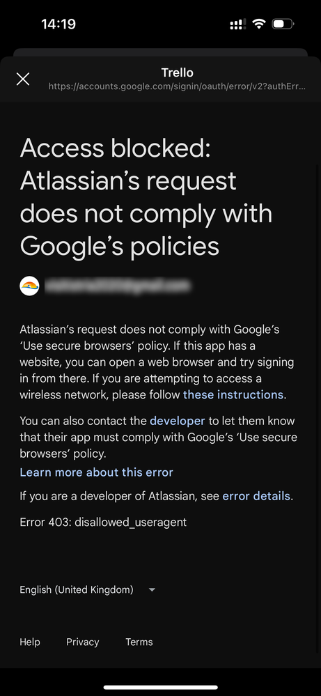

6. ERROR

Thanks for sending the screenshots. I can see you shared your email address publicly, which is not allowed by our Community policies, so I replaced your screenshots with the email address obfuscated.
Trello authentication usually opens a default web browser's window to authenticate, then redirects to the application again. Apparently, Microsoft Teams is trying to authenticate Trello through Teams app instead of opening a new web browser window, which causes a Google error message.
Could you please set Google Chrome as your default browser and let us know if you see the same error message? If so, please try to copy the URL at the top after clicking "Log in with Trello" and open it using the web browser. Let us know how it goes.

Hm i tried to set the Google Chrome, same error also i tried to copy the URL but its not possible to copy it from the app.
