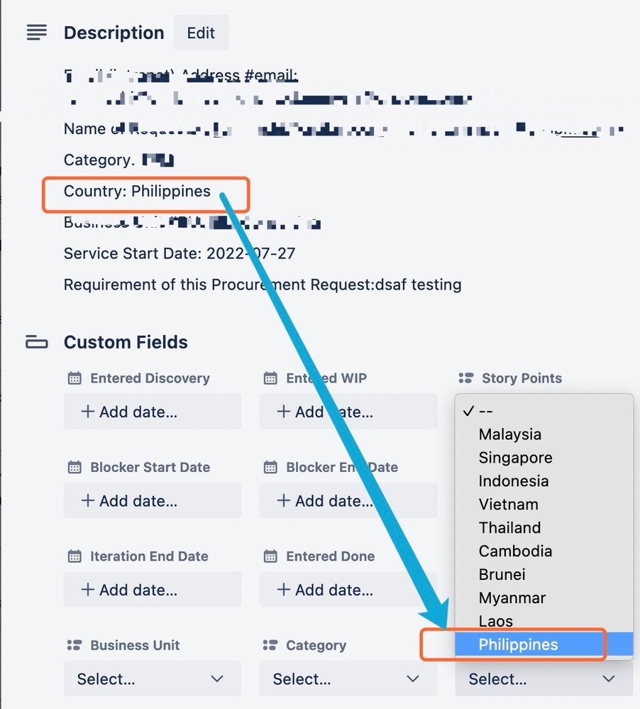

process and questions:
  • 1.  the card is created by "Email-to-board" function
  • the description has various field such as Country, Business Unit etc.
  • The format is stable  Country: {countryname} such as in below red rectangle.
  • when the countryname parameter is Philippines,  prefer to have an automation rule to select  Philippines in the dropdown custom field Country.
How to set the rules??
3 answers
Tammy Shi
August 1, 2022
when the description of a card contains "Created From:{*}\nRequestor Email:{*}\nCountry:{*}\nCategory:{*}\nBusiness Unit:{*}\nService Start Date:{*}\nEND", set custom field "Created From" to "{wildcard1}", set custom field "Email Id" to "{wildcard2}", set custom field "Country" to "{wildcard3}", set custom field "Category" to "{wildcard4}", set custom field "Business Unit" to "{wildcard5}", and set custom field "Service Start Date" to "{wildcard6}"
